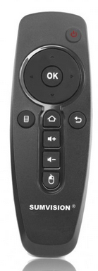

Anyone have a remote config for the sumvision cyclone x4 Plus
