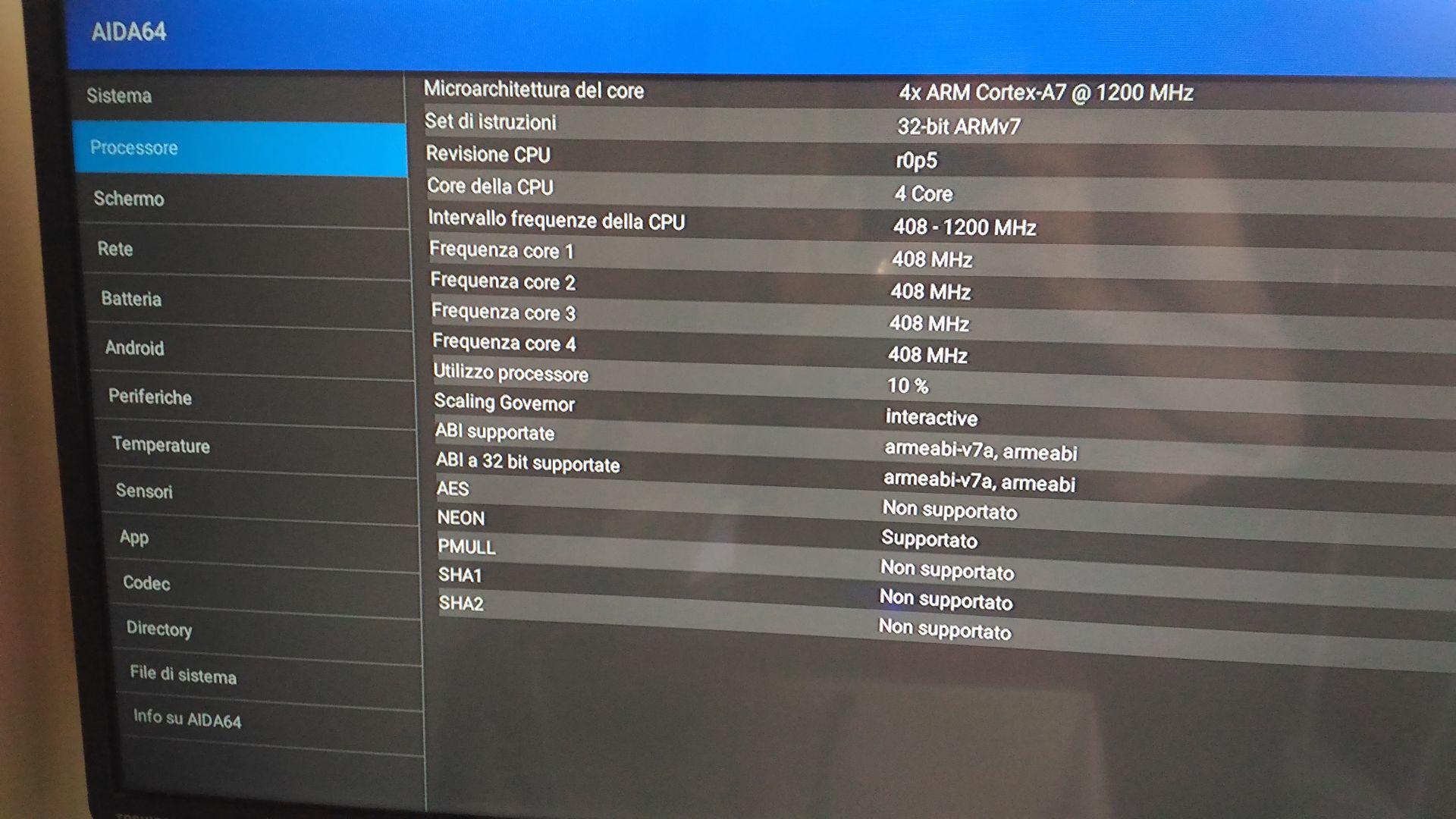

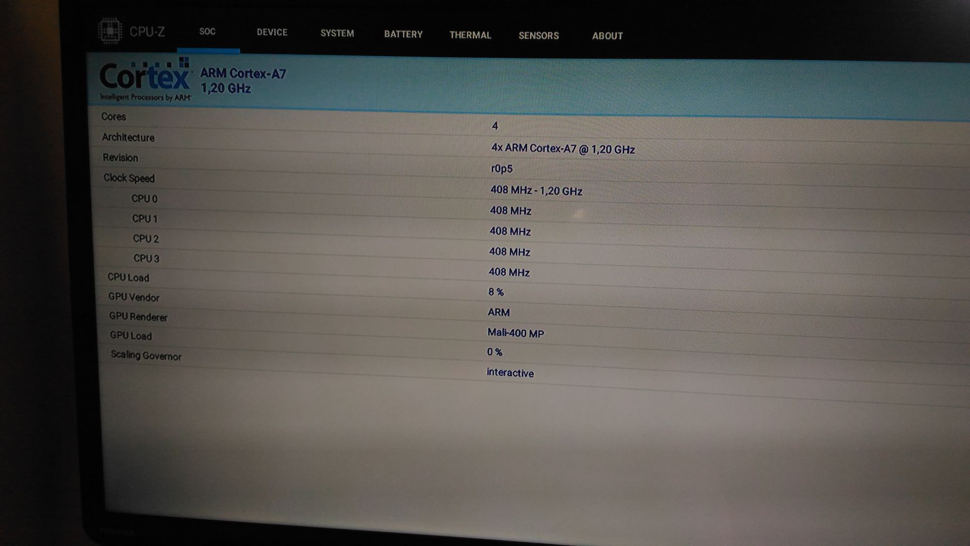

Good afternoon everybody.
Sorry for posting here, but I would like to ask a question since in this Forum there are very experienced people on the subject:
would any of you be able to tell me what kind of box is this?
The pbc photos are at post # 390; attached the screenshots made with AIDA and cpu-z.
It's just curiosity, but I think it's a very strange box .
A thousand thanks

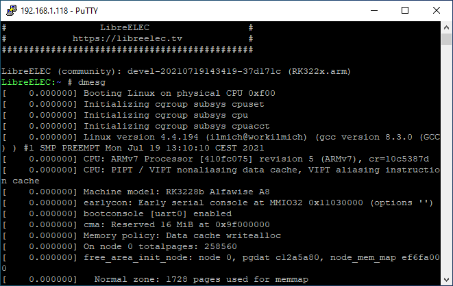

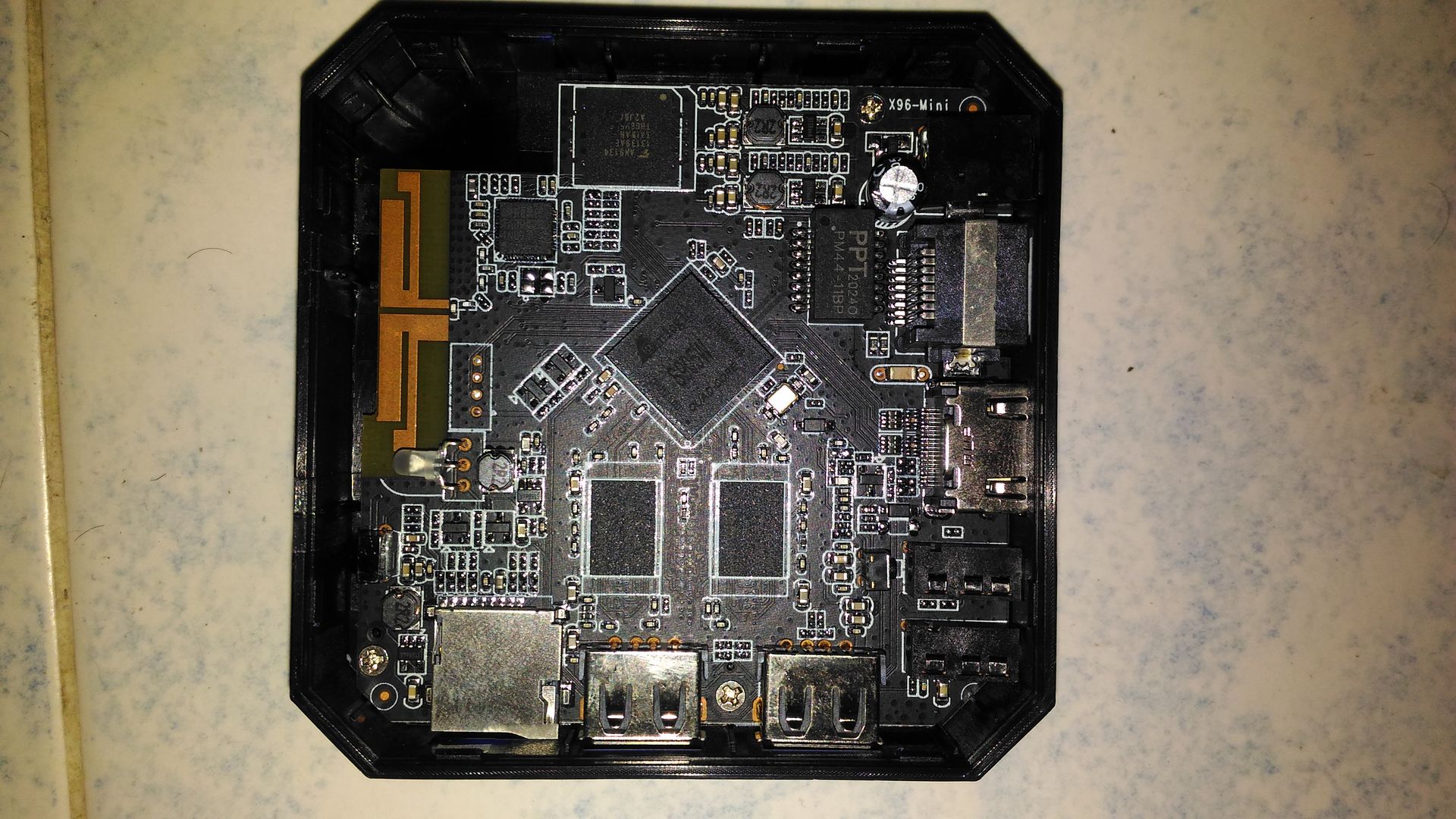

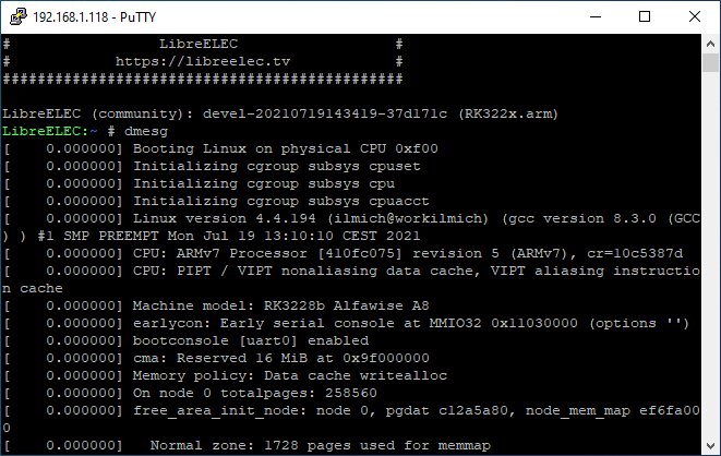

Good evening everyone.
I want to share my experience, maybe it will be useful to someone.
I bought a cheap android box (€ 19.99) x96 mini to tinker and test.
The characteristics had to be: 4/32 gb, Cpu S905W.
The manufacturer is a genius: I will show you some unbelievable photos attached (of course they are original photos not retouched).
Before trying it, I opened it, to actually check the cpu: S905W, but there was something strange, the chip was transversal compared to all the others (classic by Rockchip), but I didn't give much importance to this ....
The stock rom works very badly, so I download some firmware for s905w to upgrade. I connect the box with the usb m / m cable, but the device does not connect.
I try to update from sd, nothing. I try to install LE, AE, CE, but to no avail.
At the end, I insert the build on the sd: LibreELEC-RK322x.arm-9.2-devel-20210719143419-37d171c-rk3228b-a8.img and the system starts !!!!! It's a RK3228b Alfawise A8 ....
I am attaching the photos and for what it cost, I won't even send it back to the seller.
