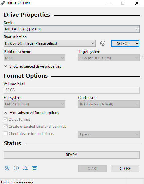

    Try burning using LibreELEC.USB-SD.Creator.Win32 - received error as per screenshot.
    **Got some info from SD creator failing with Windows 10
    Try burning using Rufus = received error "Failed to scan image"
    Managed burning image (minix_x8_x8plus_x8_h_newbootloader_FW9) using Burn_Card_Maker_V2.0.3 without error.
