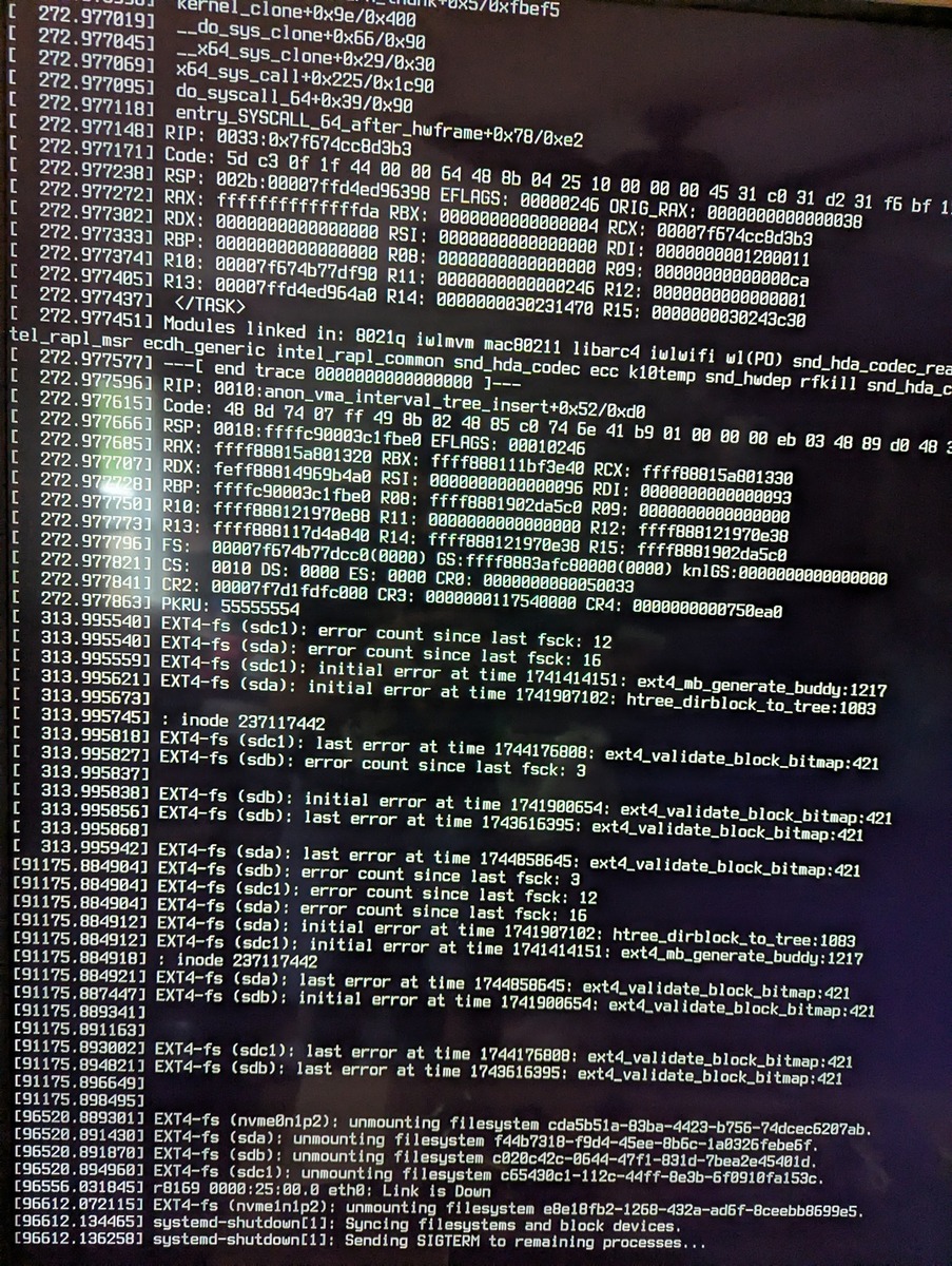

i have 2 spinning drives by sata on a biostar a68n hooked up to the tv by hdmi. no external speakers. while watching movies, i'm getting intermittent stuttering every now and then. usually twice a day just randomly. it happens in the middle of watching any video. it will freeze for a second then it fast forwards to catch back up. here is the log it gave me. we were hit by lighting recently so i wouldn't dismiss it being hardware related.

There are two major issues in the log.
1. Kodi is crashing when closing the video database. May be a broken sqlite DB file.
2. The file systems on your HDs (except the NVME) are broken.
I do recommend a system backup (via LE settings) to an external media first, then fixing the errors before trying any larger updates.
okay. can you recommend a good way to prepare the drives? i used ubuntu to do a fresh format in ext4 on all drives. i do have minitool partition wizard i can use. i just figured doing through an actual linux distro would be better. they were all brand new drives and all were formatted back to back in ubuntu. do you think i may have done something incorrectly or with the wrong setting? or could the filesystems have just become corrupted this quick from crashing (3 months)? this is my first time using ext4. previously i've only used ntfs. i do have backups of all drives, i just hate to wipe and copy everything back over. not the end of the world just takes days. i see it says "running e2fsck is recommended". is there a tool to repair the filesystem to avoid formatting? i have Parted Magic and UBCD. would those help me at all?

just an update. i got this on screen today. first time i got to see in real time what just happened. i can see all the ext4 errors you're talking about.
