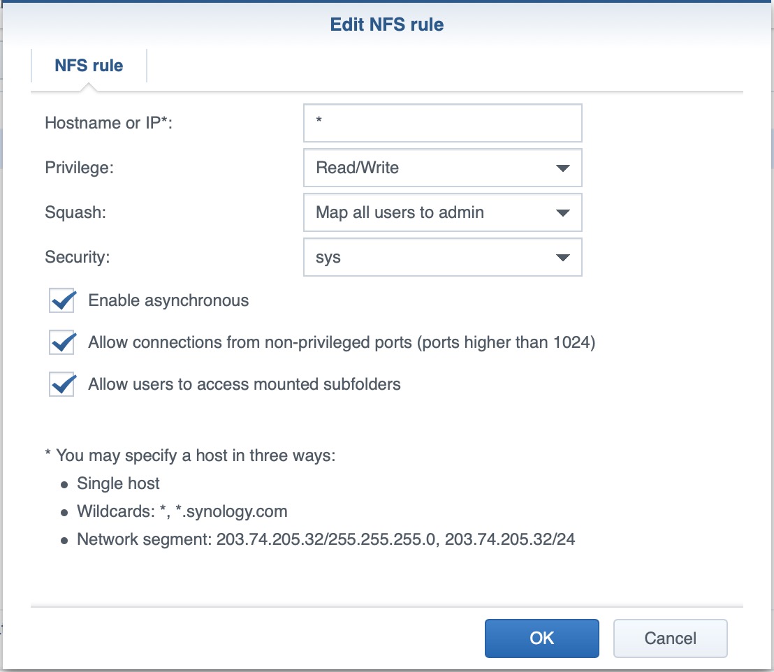

I changed the squash settings to "No Mapping" and it looks like I can SSH in and it accepts the password and appears to be working. Kudos to mglae for helping me out. looks like the squash settings was the last piece to making this work. Now if I can just get the booting to be a little more reliable (about 1 in 4 boots fails at a black screen and no activity light)... but that's for another thread and may not be LibreELEC related.
Unfortunately I don't use Ubuntu. My setup is a Synology NAS hosting the NFS share, Unifi using DHCP Network Boot options to point clients to the NAS TFTP/PXE server hosting bootcode.bin. This is the guide I followed for the NFS share: Network Booting LibreElec to Raspberry Pi's from a Synology NAS - Upods.netUpods.net and this link for the TFTP/PXE server: DiskStation Manager - Knowledge Base | Synology Inc. and I think I found a few pointers for the Unifi configuration on their forums but don't remember exactly where I found them.
From the first guide, the squash settings are set to map all users to admin. I followed all other settings in that guide. I might have changed 1 or two things like the exact folder path, but none of the other settings changed that I remember. Here's a screenshot of my Synology NFS share permissions:
The options in the squash settings dropdown are:
- No Mapping
- Map root to admin
- Map root to guest
- Map all users to admin
- Map all users to guest
my /etc/exports file does not look like what is in that wiki guide:
Code/volume1/Saturn *(rw,async,no_wdelay,crossmnt,insecure,all_squash,insecure_locks,sec=sys,anonuid=1024,anongid=100)
And with this being on a Synology, I'm not quite sure what would happen manually editing that file. It may get overwritten, or not survive reboots, etc.
Even on a fresh install the files/folders get owned by "admin". This most likely has to do with the pxeboot setup, but I'm not sure. That's the user "1024" in place of the root user on the ls -al command. If I try to chown -R root /storage I've experienced both the inability to boot and an error in the command line effectively saying it wouldn't let me.
