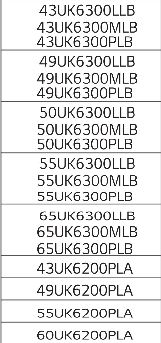

1 TV here is an LG 60UK6200 which we bought in 2019 so it's 3 years old not 2 as I mentioned. It's a low budget smart TV with webOS. According to the pricewatch of Dutch website tweakers.net the model entered the market in February 2019:
LG 60UK6200PLA Zwart kopen? - Prijzen - Tweakers
Another LG TV is several years older. Not sure how old because it came with the place we rent. It's not a smart TV (no webOS) and it has the same issue as our smart LG.

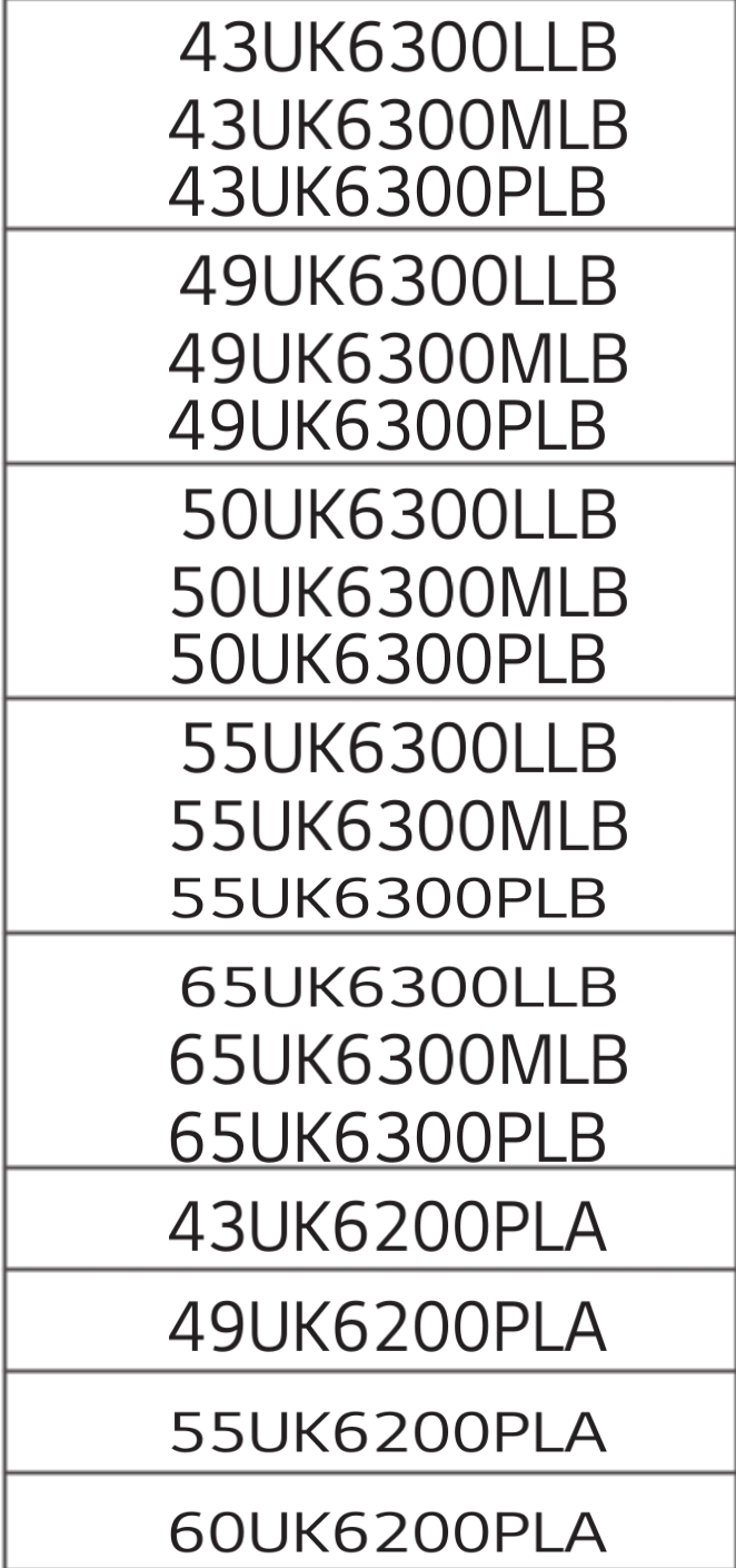

The manual of the smart TV here mentions a whole list of models so they might all cause the same issue. See attachment for screenshot of that list.
AFAIK no developer has been able to reproduce the issue - it seems to be limited to a few specific older models - and without being able to reproduce the issue it's next to impossible to fix it.
