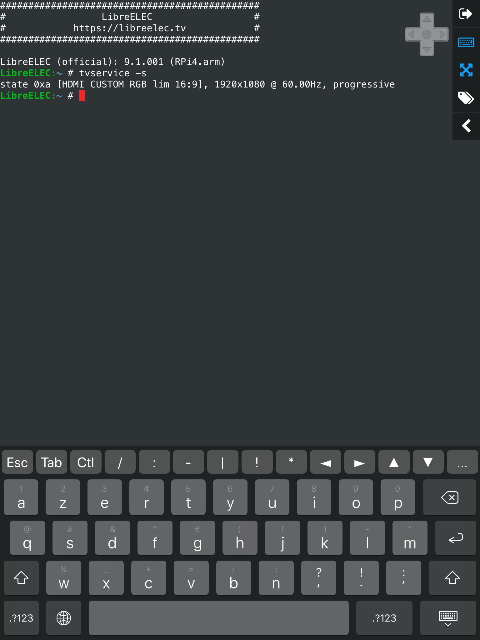

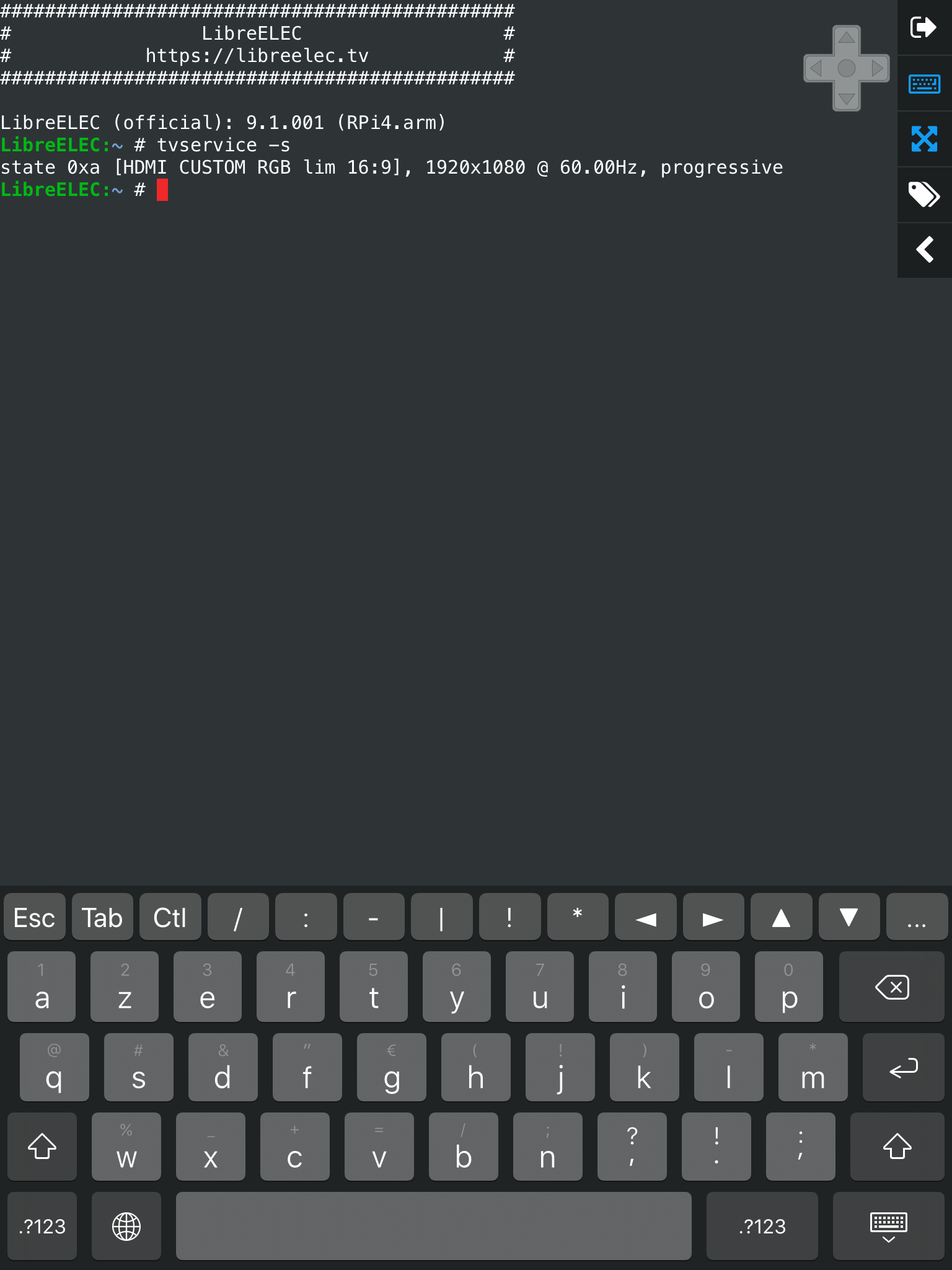

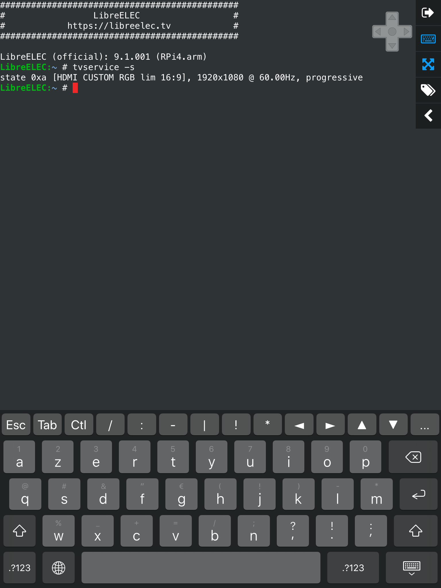

    Can you ssh into the pi when display is working (direct connection to TV) and when not working (going through amp)
    and report output of "tvservice -s"
    I wonder if the amp is advertising support for 4kp30 which the TV can't handle.
    i manage to ssh and here are the info i get:
    with amplifier plugged:
    and with TV plugged:
    seems pretty the same to me..
