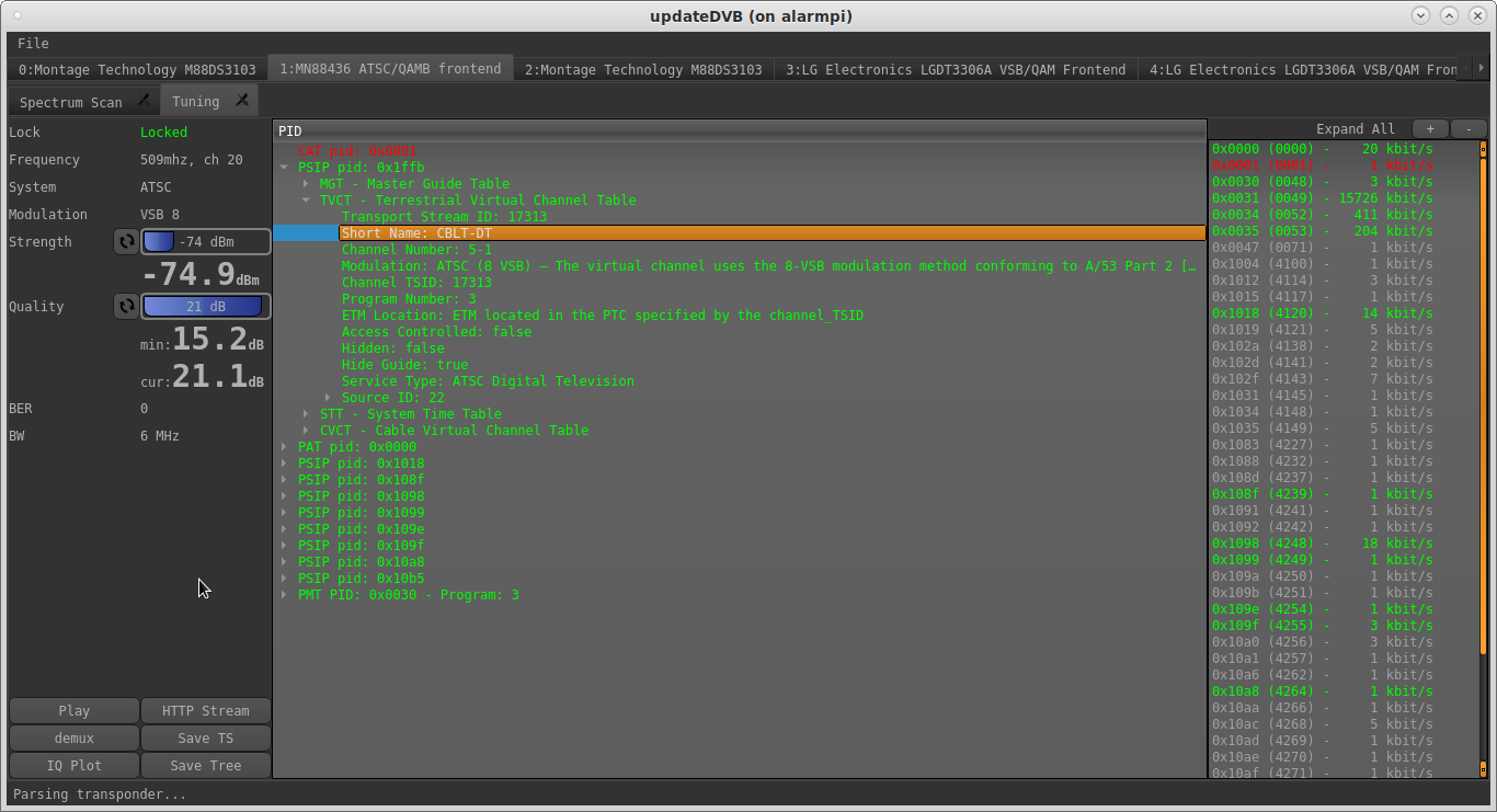

    Couple of snapshots to demonstrate how well the geniatech hdstar Hardware revision 3 works here.

    I would enable the real stats in your tvheadend configuration to display the signal stats in dBm for strength, and dB for Quality.
    The percentages ur looking at for comparison are useless... If you notice in my screenshots, the strength dBm and Quality dB are identical to
    the updateDVB program I am using.
