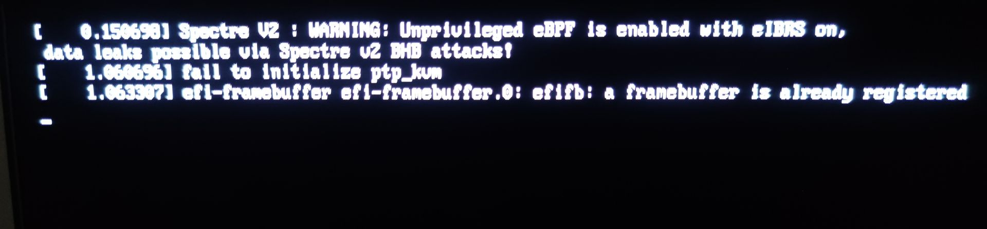

Unfortunately I get the same error with this build.
Post #1 updated with a link to a new build.
Thank you very much!
//Edit: Same problem J5005 NUC here, failed to intitialize ptp_kvm
