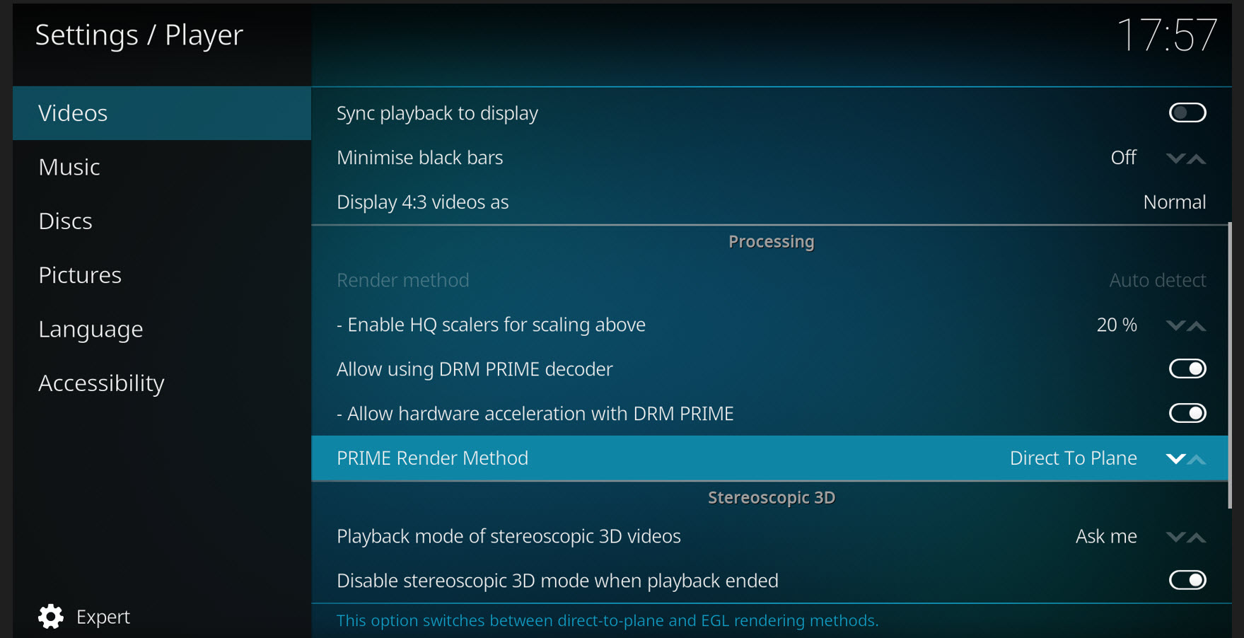

    Btw, these are my video settings (both in 10.0.2 and 10.0.4):
