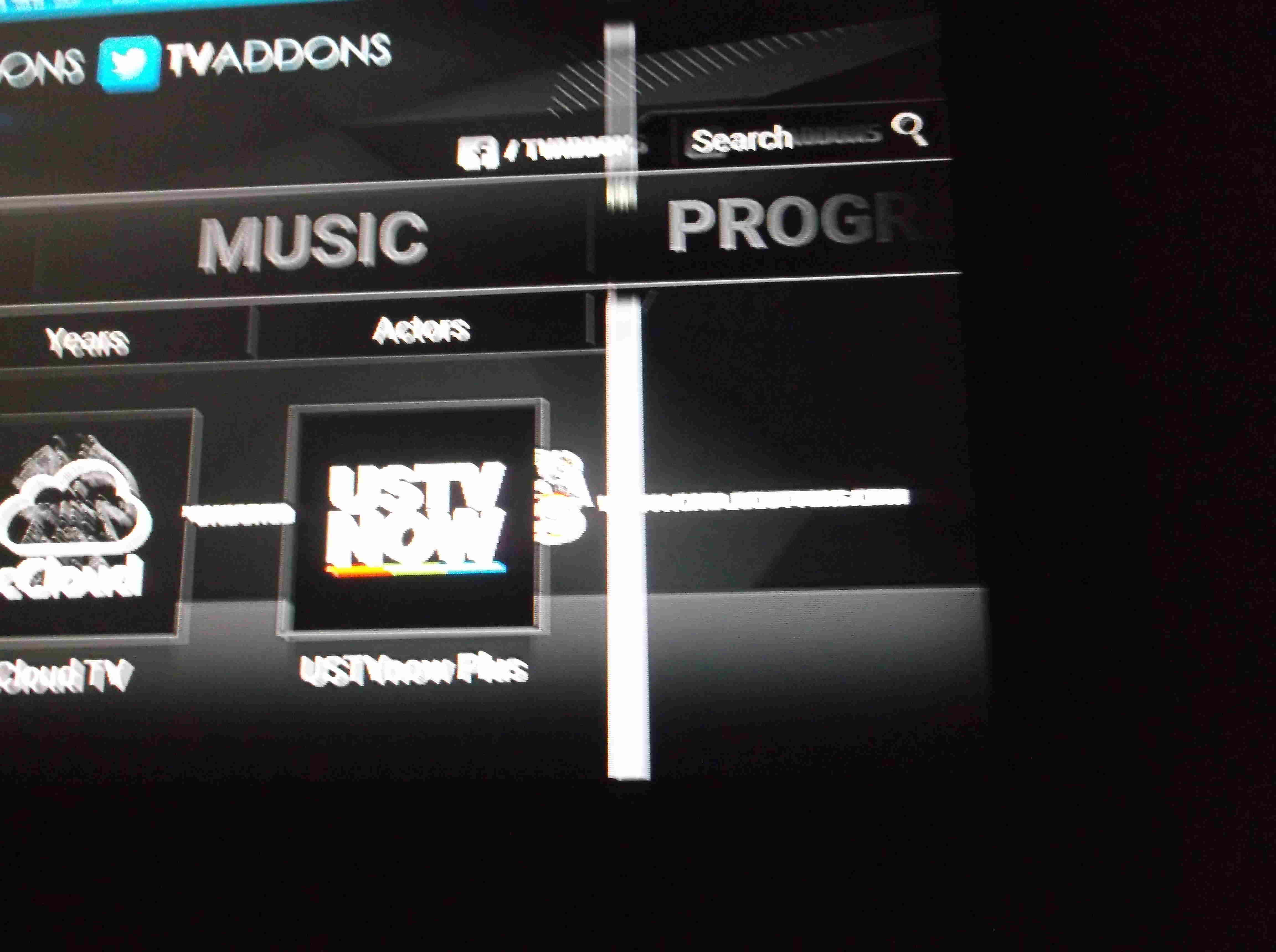

Mouse, horizontal lines across the screen.That's really all the information you can supply?
How about donating us a crystal ball instead?
You must have a whole lot of time on your hands.
I no longer have a nice pointy triangle. Instead, I have vertial and horizontal lines across the whole screen, which move when I move the mouse, but don't seem to show the position of the cursor. I haven't tested whether the mouse buttons work because I can't figure out where the cursor is.
