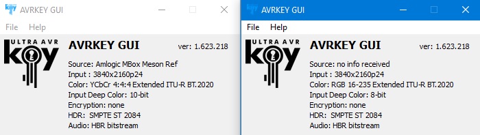

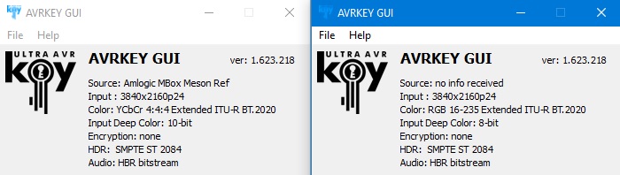

    Yeah, it forces the output to 8-bit.
    Did you ever try Windows on your NUC? I wonder if Windows driver also force 8-bit.
    I have used hdr quite a bit on Windows.
    Funnily enough with my old Samsung tv I was getting constant white flickering - so a while ago I contacted Intel support about it, and after a lot of back and forth they eventually came back and said that the NUC did not support 8 bit, only 10 bit and the reason the flickering was occurring is to due to the tv panel being 8 bit. Can confirm on my new 10bit tv it doesn’t occur so not sure whether it was true or not.
    At any rate - that’s why I was curious about this patch forcing 8bit when the support people told me it could only output 10 bit - maybe that’s a Windows ‘hdr mode’ thing?
    Edit: this is the reply I got, maybe at the time I just took that to mean it only outputted 10bit...
    Of course, I’m sure the devs know a lot more than the support :P
