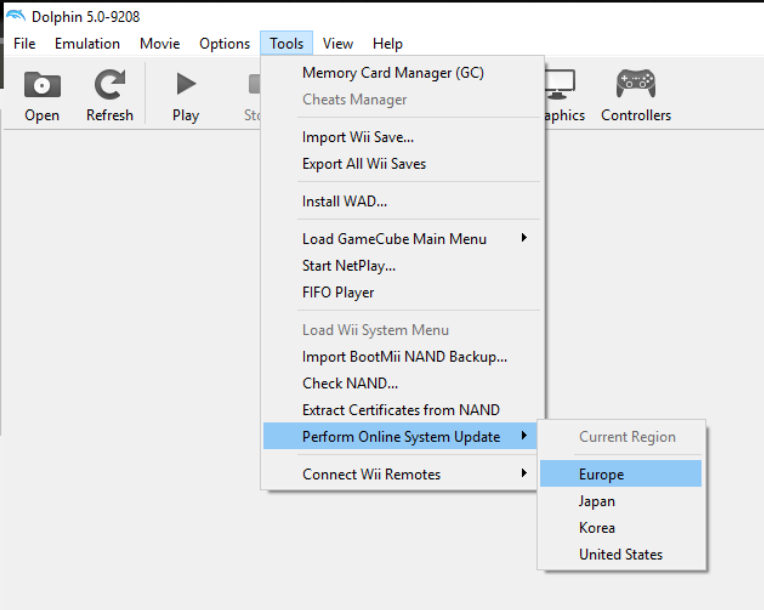

    You don't have to install WADs manually:

    Which emulator do you use? lr-dolphin (Retroarch) or Dolphin standalone? Since you refer to a User directory I guess lr-dolphin so delete the retroarch-core-options.cfg file in your Retroarch config directory.
    Dolphin standalone: i fixed it by installing the Wiii System Menu WAD, start the Menu and in settings you can then change it to 60 HZ under Screen settings.
    How to "System menu": How to get a fully working Wii Menu..
    NUS Downloader - WiiBrew
    I Used : v48x (4.2x) (latest didnt seem to work)
