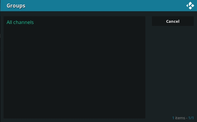

Hello,
Multiple groups per channel (separated by semicolon in m3u file) do not work. I just have "All channels" in the group list.
I use Kodi 18 RC2 and PVR IPTV Simple Client v3.5.5.2
It works fine on Win7 64bits.
Thanks
