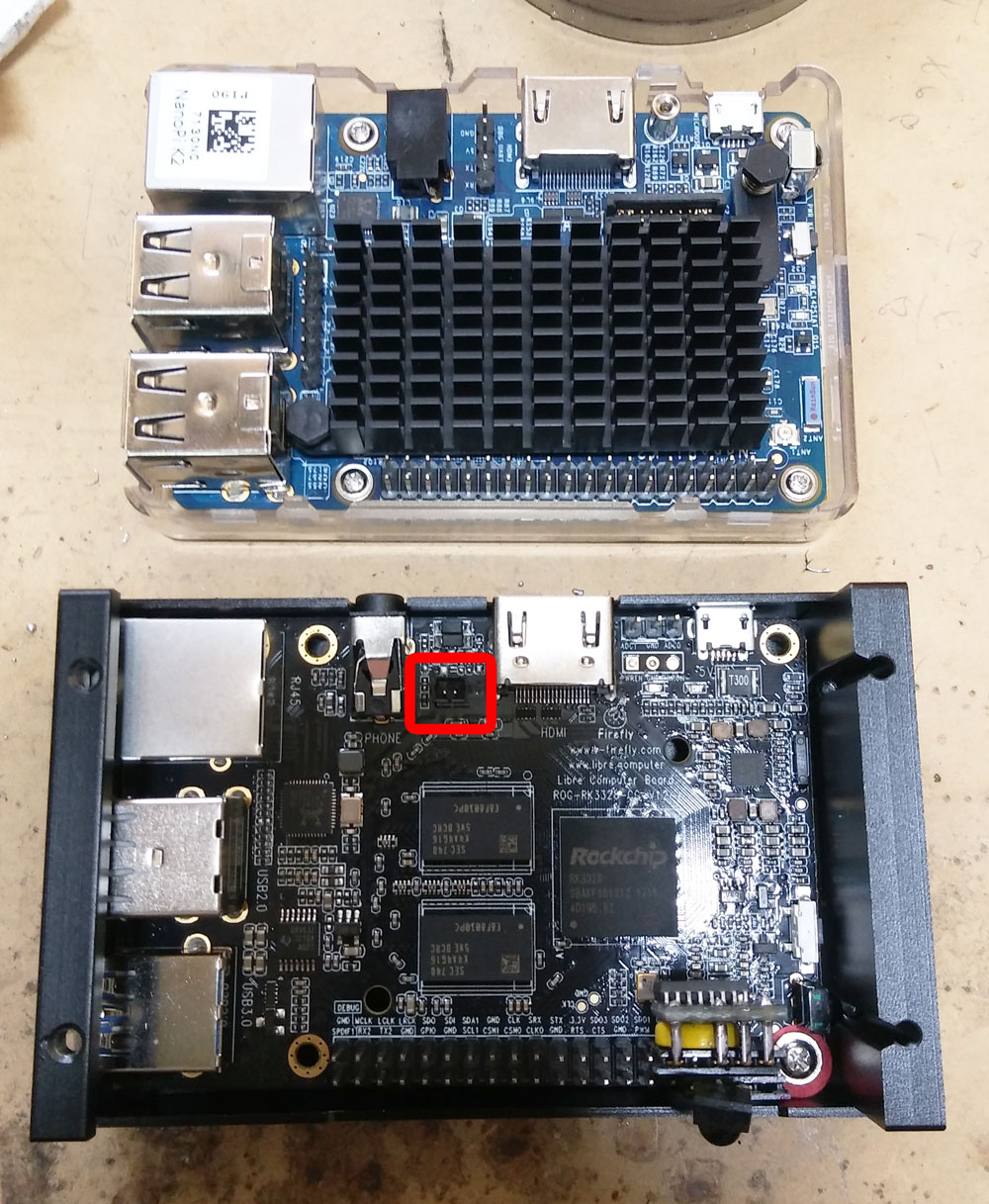

    I have a Firefly ROC-RK3328-CC 1GB version 1.2 and they have added a jumper for RTC backup battery as I have showed it in the picture below,
    All you have to do is to connect a 3V battery with 1.25mm jack to it and set the time. (Left pin +, Right pin -)
    In this image you can see that I have DS3231 connected as well but it doesn't work since I2C 0 is disabled by default and you can see an extra IR receiver because the box is fully metal and when it's closed my remote won't work. For IR receiver you can simply connect the data pin to the data pin of the onboard IR receiver.
