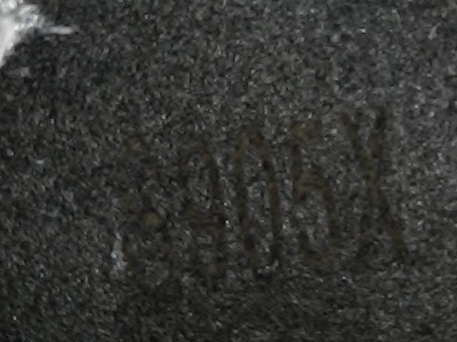

Before we move on, please remove the heatsink from the processor and check the exact type of CPU to avoid suspicion of installing a wrong bootloader.
Yes, S905X on the PCB
Full output and Libreelec is not loading

In the s905w folder there is the gxl_p281_1.dtb.
I have a S905X and there only the gxl_p212_1g.dtb in the folder.
However I remember seeing the p281 board when evertthing was running fine.
Can I swap the file?
GitHub - AlexELEC/S905-trees: Device trees for Amlogic S905/905X
What files should I have on the SD CARD at this point? I just want to bring the unit back to life, so any rom is good. thanks
Hello all
this time I'm really really stuck.
I have this box:
http://www.mario-sz.com/product/Priv...e-Q1-905W.html 8gb/1gb
The website shows that the unit it's running the S905w,but he actual chipset, under the heathsink, it's a S905X
The print on the PCB shows S905XQ4_V1.0 (Probably 4th quarter , since the date is 2017.11.23)
The units prior to the incorrect upgrade was running Android 7.x.x and on a P281 board
I tried several IMG using burning tools, but the flashing procedure, hangs at 7%
The unit will only go in recovery mode using an SD card with nhg47l/20180313
I'm not able to apply any update via EXT , either SD or USB.
I connected at TTL interface to the unit, so I'm able to use the internal software and type commands
At this point I would like to simply restore the OS to anything more fancy than a black screen.
I need a file to reinstall the recovery mode and then the OS when the unit is booted from the SD CARD,
Please check S905X bricked - Pastebin.com for the output
i believe the u-boot is corrupted and the different partitions broken.
Thank you in advance
