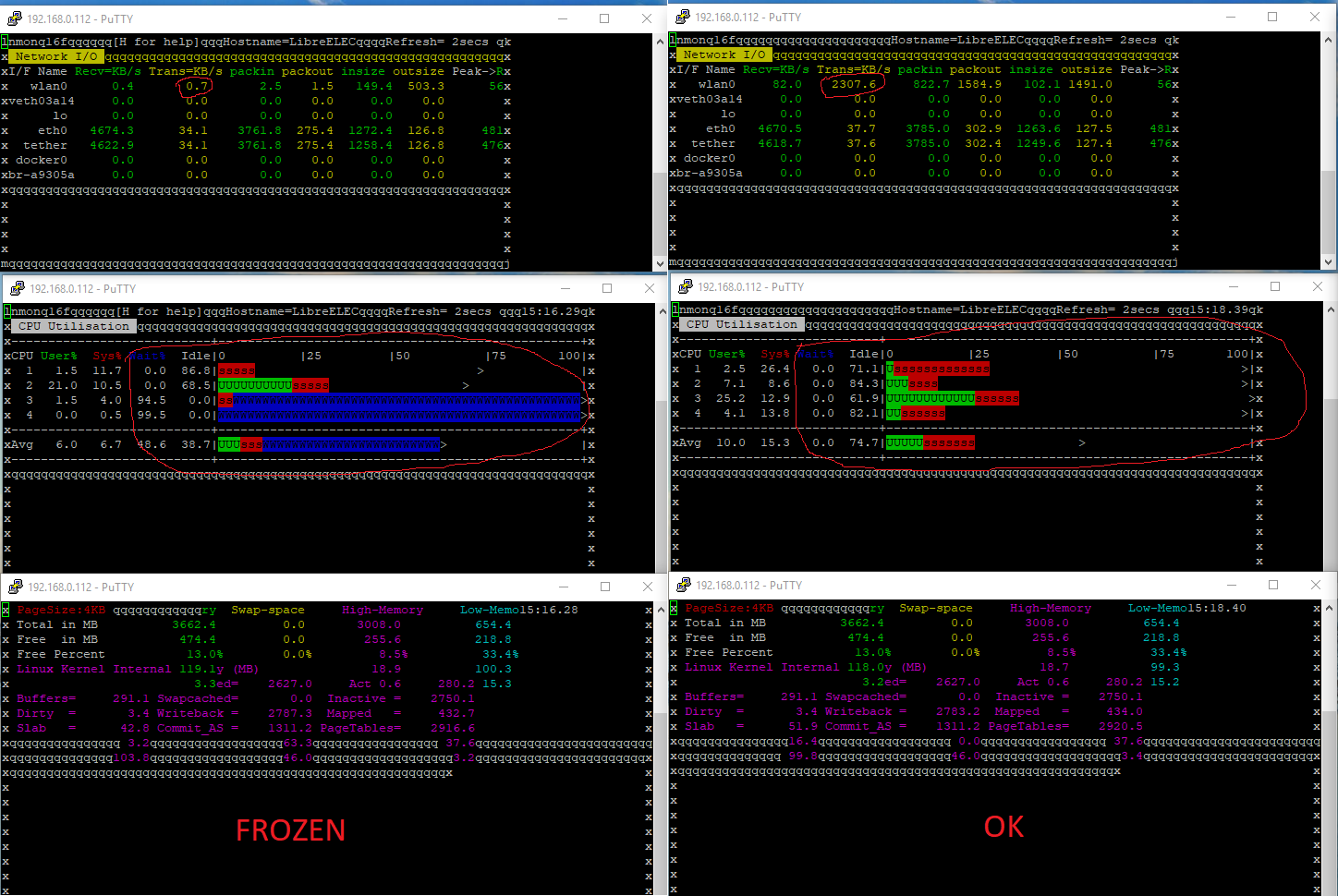

Ok my setup is a Server running Libreelec on a Pi 4 4gb. Its running tvheadend latest version. 9.1.901.444
Once in a while I am watching live tv and the image if frozen for between 5-30 seconds and after it starts playing again.
This happens mostly when watching live TV.
I installed the necessary addons to start a basic diagnostic to understand whats going on when its frozen.
When running normally, I see in my Network I/O using NMON that its transmitting fine and all my CPUS are mostly IDLE.
When it freezes, Half my CPU's are on WAIT and the Transmitted info is at 0kb/s.
I checked the logs and nothing was printed at that time.
No recording were active at that time and Timeshift is active.
Any idea on what to check next?
Thanks
