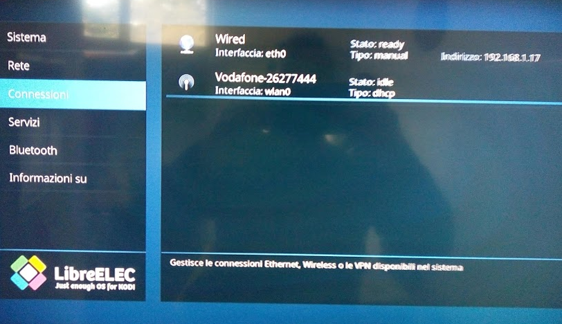

Fixed ip stable with changed mac, but things are working and not working with only wifi and only ethernet interface activated. Modland worked and also another plugin, but after a reboot they doesn't work again.
If I put the sd with unstable ip and not working installtointernal version all is ok.
not sure i fully understand. i've test the images: kodi repo, LE repo are available and work like expected. i've install a few addons without any troubles.
# 1 updated

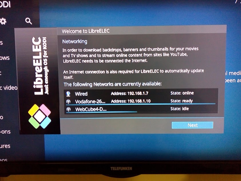

Tryed another sd clean install: 'Could not connect to repository' with kodi repo and Libreelec repo working. This happen with ethernet connection,
With wifi all is working ok. If I disable wifi and back to ethernet kodi repo seems working, but can't download from some sources. Modland addon too seems can't connect to internet.
Switching back to wifi all starts working again. Note not all internet conneciton is not working with ethernet: I was able to install simple pvr client from libre elec repo.

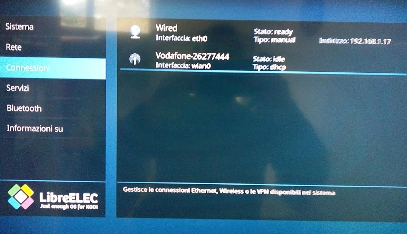

I can confirm installtointernal is OK and non-dhcp IP is fixed.
Manual ethernet configuration is working and mac doesn't change every reboot. Thanks!!!!

Can't fix ip in ethernet interface: mac always change. Also if I put libreelec config -> manual configuration for ipv4 and save at reboot it return auto-dhcp.

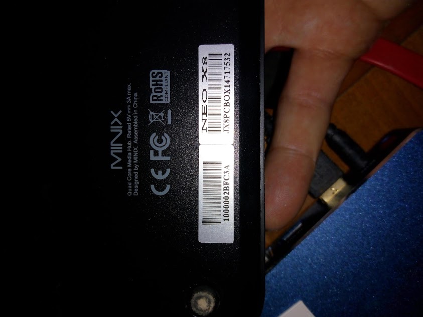

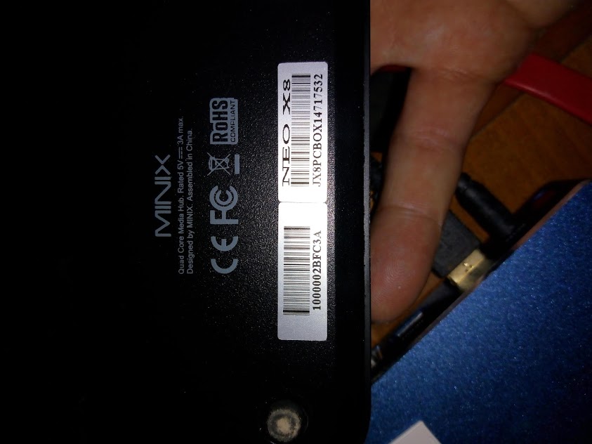

as far as i see, i don't have a working img for the X8.
I think mine is X8 and boots very well ..or I'm wrong?
