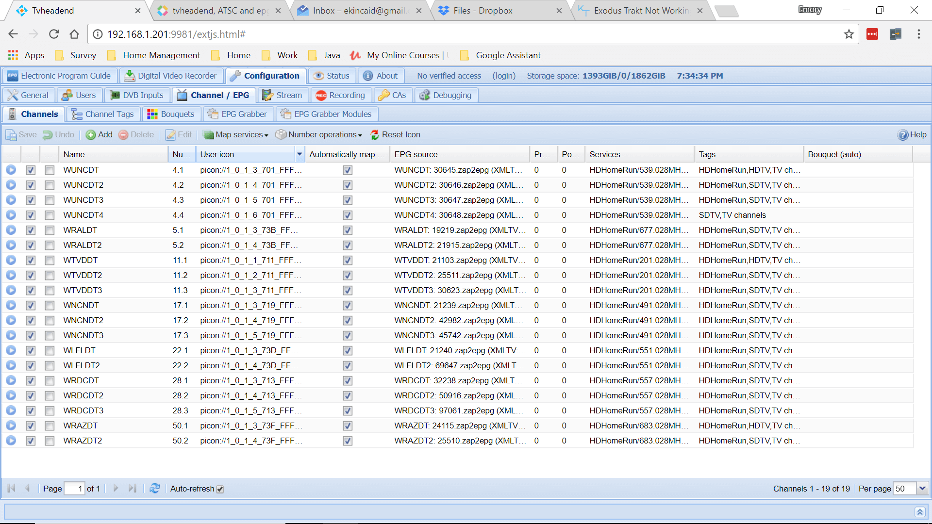

When I look at Configuration\Channel / EPG\Channels\, ALL channels are pointed to correct EPG Source (#####.zap2epg)
If I look at the Electronic Program Guide tab, I only see programs listed for channel 50.1 which is 24115 in the xml file and 50.1 programs are all that show up in the program guide in Kodi.
Here's a link to it...
I may have spoken too soon. If I look at my xml file it is filled. Looking at the EPG Source on the Channel tab, only one station appears. The others that are in the xml file do not show. Any thoughts ?
