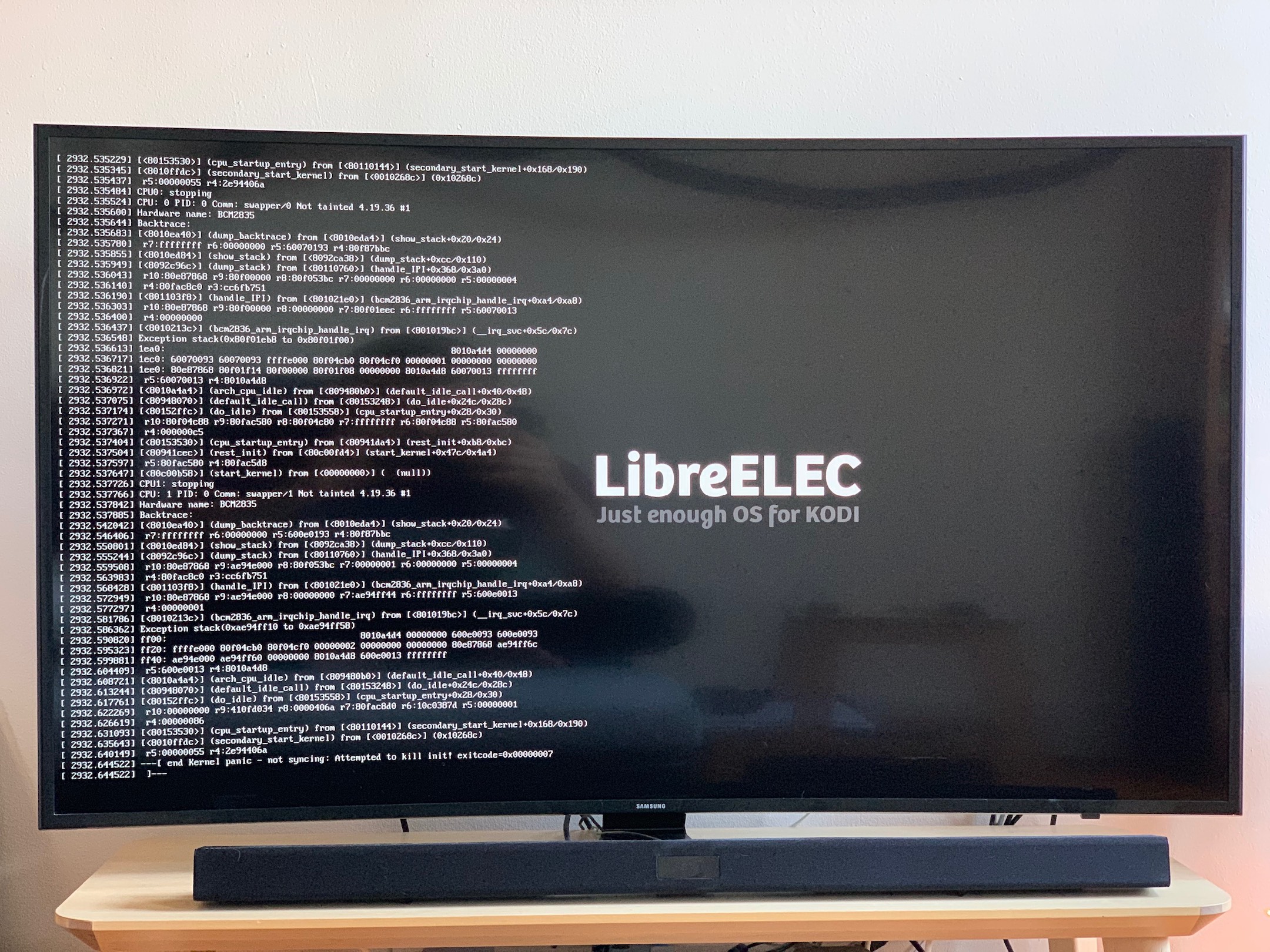

    Hello,
    Looks like there's a Kernel Panic affecting multiple users, possibly after some recent auto-update. Please see attached images.
    I was traveling for a couple days and, upon return, I saw this Kernel Panic error. Nobody was at home to touch the media center while I was out, and the same error is hapening to other LibreELEC users, this is why I'm guessing this could be caused by an auto-update.
    Any suggestions to fix it? I could reinstall from scratch and recover the configs from a recent backup, but maybe someone has an easier way to fix the current kernel panic without reinstalling?
