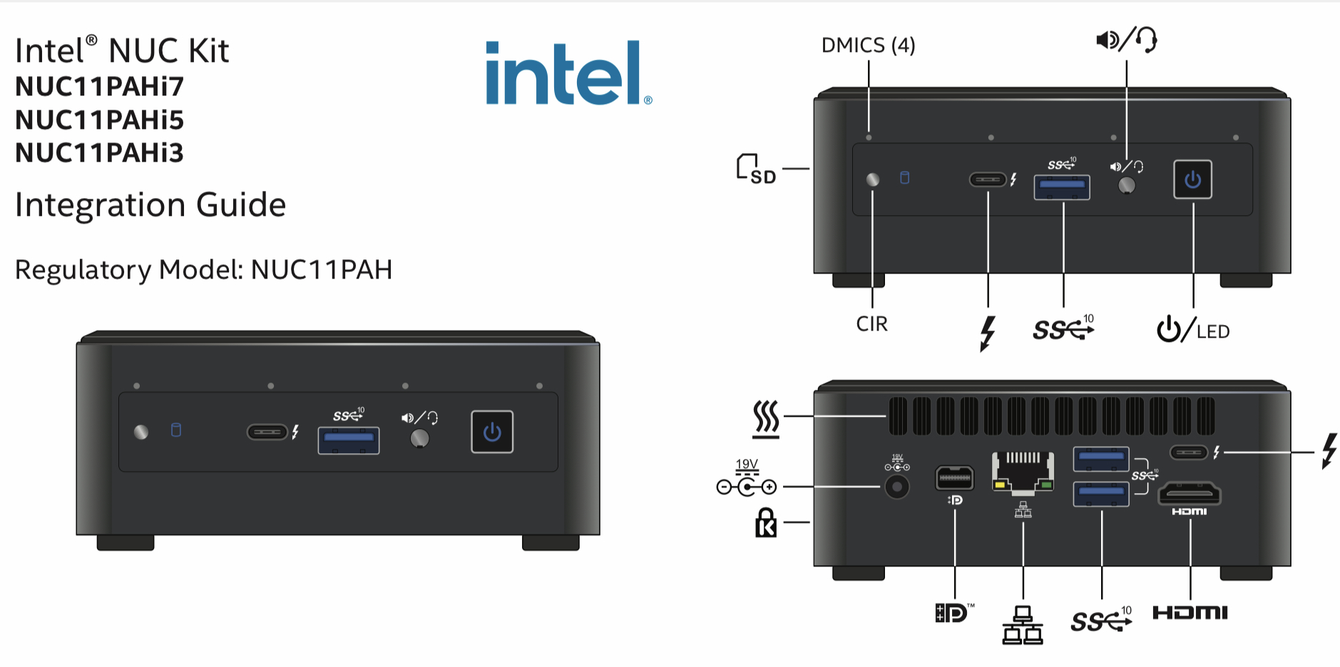

Hi GDPR-7
This is the model - I have
- https://ark.intel.com/content/www/us…nuc11pahi7.html
- https://www.intel.com/content/dam/su…ation_Guide.pdf
And I am connected to the HDMI port.
[ 0.000000] DMI: Intel(R) Client Systems NUC11PAHi7/NUC11PABi7, BIOS PATGL357.0041.2021.0811.1505 08/11/2021
After a clean boot 5.16.1-rc1 (with HDMI and displaying on LG4K TV)
- card0-DP-3 shows connected when the cable is connected.
nuc11:~ # tail /sys/class/drm/*/status
==> /sys/class/drm/card0-DP-1/status <==
disconnected
==> /sys/class/drm/card0-DP-2/status <==
disconnected
==> /sys/class/drm/card0-DP-3/status <==
connected
==> /sys/class/drm/card0-DP-4/status <==
disconnected
==> /sys/class/drm/card0-HDMI-A-1/status <==
disconnected
vhgroup - can you please share a full dmesg?
- Should show the model of NUC.
- What are the errors shown in the logs?
