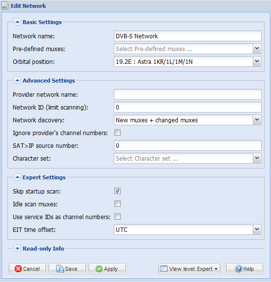

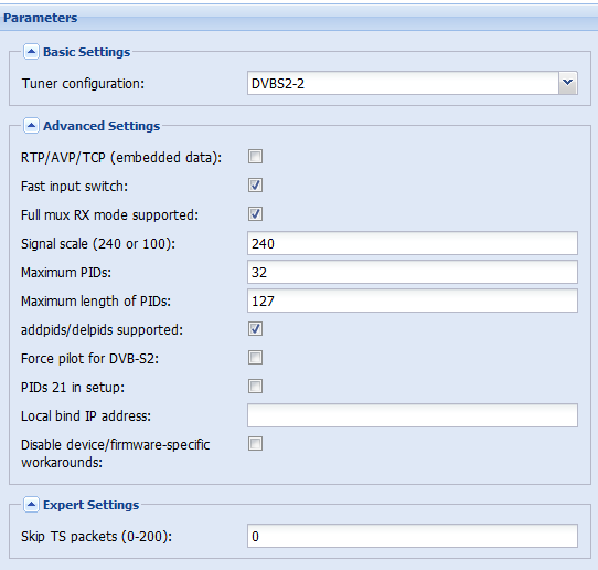

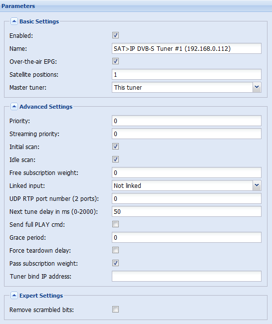

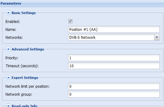

    No, i have only 2 of 4 connected. I have a Quad LNB but only 2 of 4 cables in the room. I have configured Tvh to only use tuners 1 and 2 (DVBS2-2). See screens below.
    minisatip config:
    Tuner #1 config:
    Position #1 config:
    DVB-S Network config:
    I was almost successful today. I successfully flashed the R1 with the latest satip-axe. I successfully configured oscam and I successfully connected Tvheadend. Unfortunately my scan of Astra 19,2E only resulted in one mux and six services. No matter what I tried I do not get more. I think I need your help now please.
