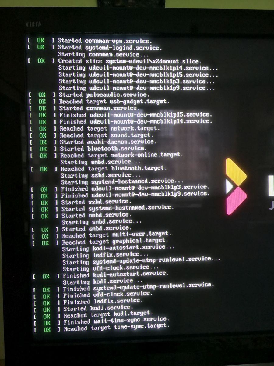

Second, enabling the log into console and sshd (following the advice from RE: My Old Minix Neo U9-H Can Be Updated?) showed that LE gets quite far in the boot process (see the attached pics).

What is also strange is when it gets stuck I cannot connect to sshd, but I can ping the box, even though it looks like sshd started correctly, which is confirmed both in the console log and also in a "postmortem analysis" of the SD card, where I can see that the ssh started and the keys were correctly generated in both the log and in /storage/.cache/ssh. But despite the positive indications the box does not respond to ssh request. From /storage/.cache/conman files I can deduct that the wired network was correctly configured by DHCP (also confirmed by ping), so some part of the network stack is running correctly.
When booting with log enabled it also looks like there is a moment (possibly around starting kodi) where it looks like LE/Kodi is trying switching the video mode but failing and continuing with 720p.
