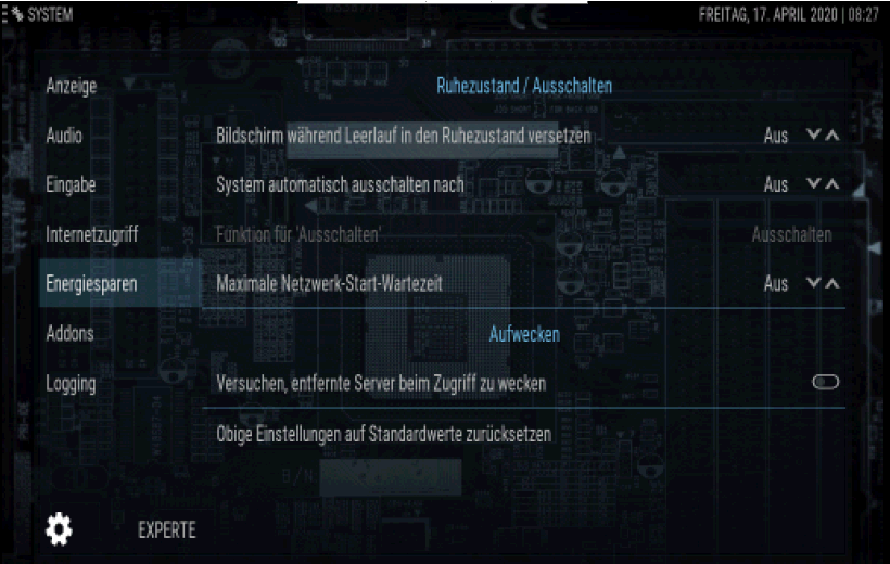

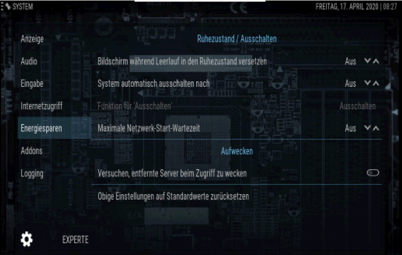

    Hello,
    I am still setting up my Raspberry 4 with LibreELEC 9.2.1
    I've had it for the past two nights that the Raspberry has shut down in the evening. But I just don't find the reason why.
    The first evening i suspected that it was due to switching off the television and the CEC coupling.
    The setting was that the playback should be stopped when the tv is switched off.
    Now i have no TV connected. And yesterday at 22:00 the system turned off. Here is the section from the log:
    I cant find a setting, that the System should turn off. In the Settings-PVR energy Saving is off. The energy saving functions are also deactivated in the system settings.
    In the TVHeadend settings i find nothing about Energy Saving?
    Regards
    Bismosa
