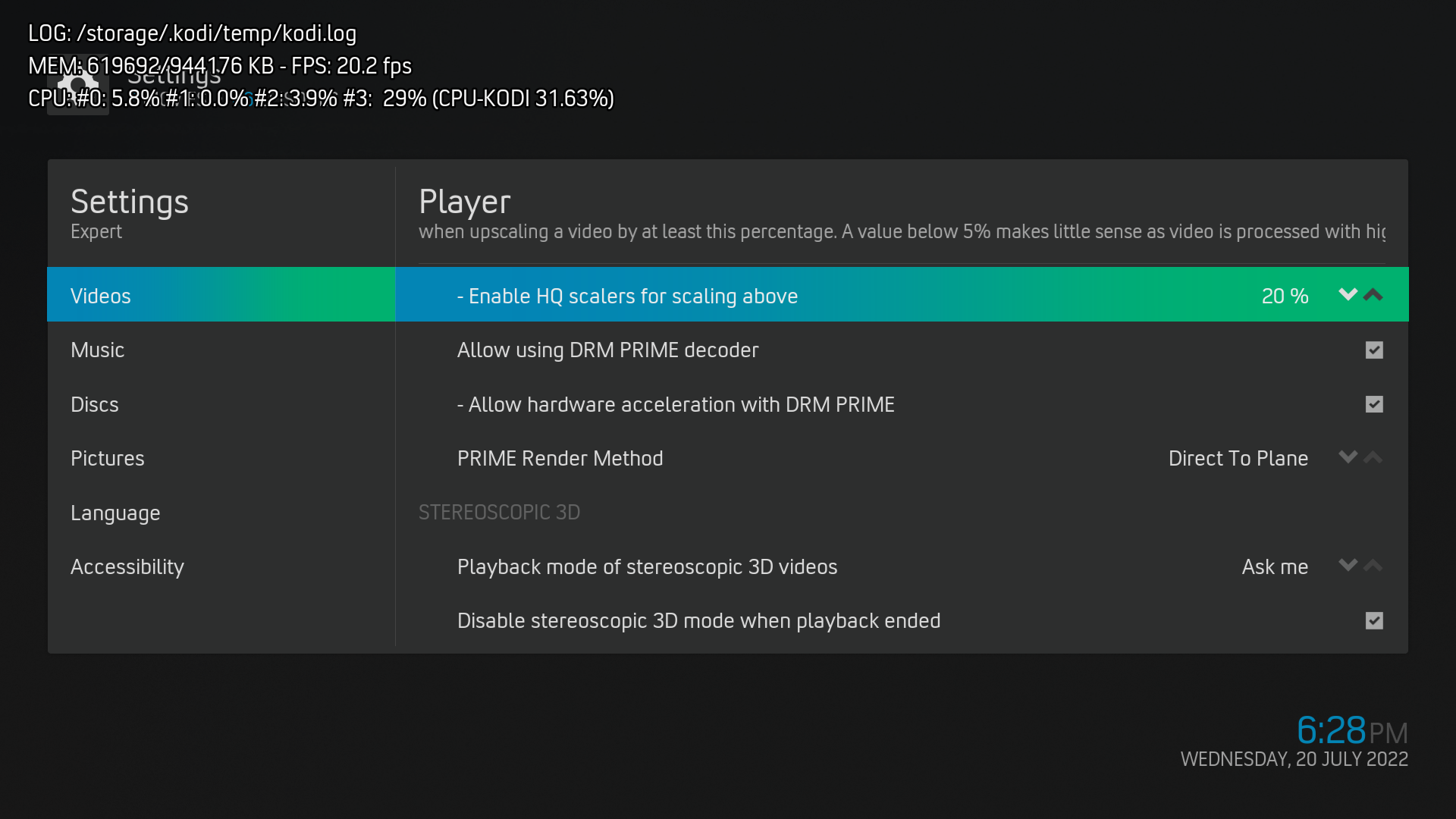

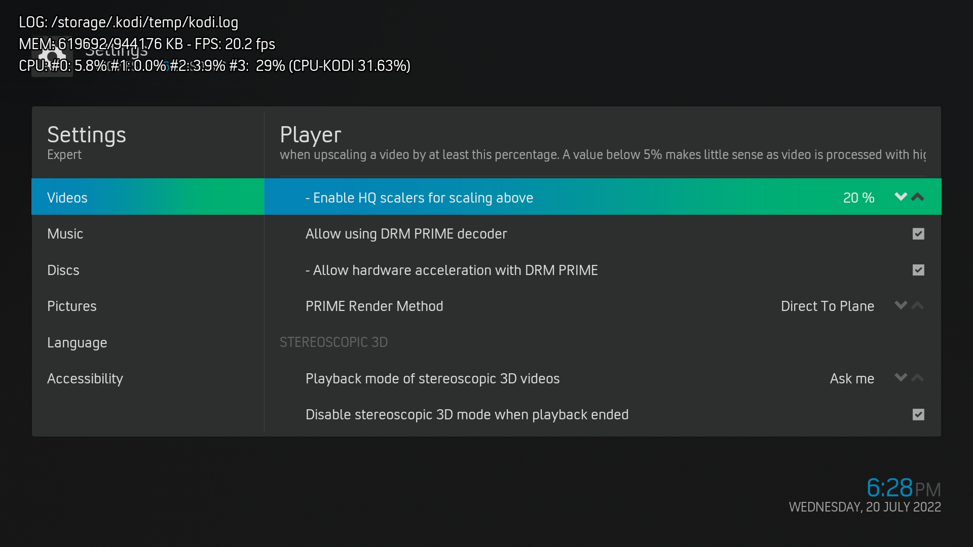

    When the problem happens trying to play the trailer of "The Iron Giant" as an example -The source of the trailer is youtube-, sometimes it only plays sound sometimes it is video with sound but with constant flickering as you can see above. Every thing is OK once I switch to full screen trailer.
    Here is my player settings:
