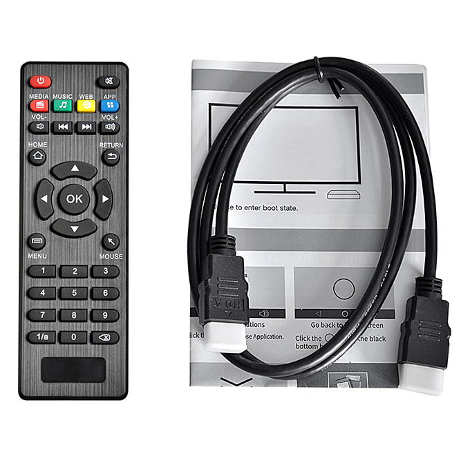

    I have a W95 (AZW/Beelink) S905w box that I'm dual booting from SD card into LibreElec 8.2.3.1. My remote is the same as in post #159 (see below for picture). My remote mostly works in LibreElec except for the colored media, mouse toggle, skip forward/reverse, and 1/a (number/text) buttons. I use a MX3 (non-IR) remote for heavy maneuvering but my goal is to use my XSight Touch universal learning remote (similar features to a Logitech remote) most of the time. Normally, I can find remote upgrades in the JP1 forum but I haven't found any that work with this box. So, the more buttons I can get working from the factory remote the more I can use my universal remote.
    I've tried several of the remote.conf files posted here but they either have no effect or work worse.
    I assume I'm going to be directed to the create remote file from scratch thread but I thought I'd ask if there is an easier path before I go through that learning curve.
    I've opened the remote.conf file from the Android OS. It has 2 factory codes in it for 2 different custom sections, 0xff000001 and and 0x7f800001. These are proceeded by factory_infcode = 0 and factory_infcode = 1 respectively.
    Any tips on how I should proceed from here to get as many buttons as possible working on my universal remote?
    Also, the power button works but are there any work-arounds for discrete on/off? I'm OK letting the box time out for going into suspend but it would be nice to have a discrete on. HDMI-CEC partially works when I'm booted into the Android OS but it doesn't seem to work in LibreElec/Kodi.
