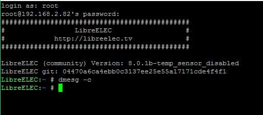

When I type in 'dmesg -c' in SSH I don't get the option to view the remote codes when I press key on my remote. I have attached what I get on SSH

thanks but i have a message that says "can not open / dev / aremote" when i'm doing 'remotecfg remote.conf' and then i do not have the wrong code message when i do 'dmesg -c'
