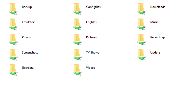

It´s the Linux path connected to the box
Your picture shows smb shares
/storage/.config is mapped to smb \\<ipfrombox\Configfiles
I recommend ssh connection and edit remote.conf with Linux editor vi or nano

Path is /storage/.config/
or
/flash (read only file system)
There is no storage folder when going in via windows...only as per attached screenshot.
My last post got deleted, perhaps because it had a link to a picture of my box/remote km8 pro?
Everything I read is saying to put the remote.conf file in a /.config/ folder but that path doesn't exist on my [8.2.2.3] LibreELEC setup on the km8 pro.
When I go in via windows I can see \\MYIP\Configfiles\rc_keymaps but putting a remote.conf file in there does nothing.
