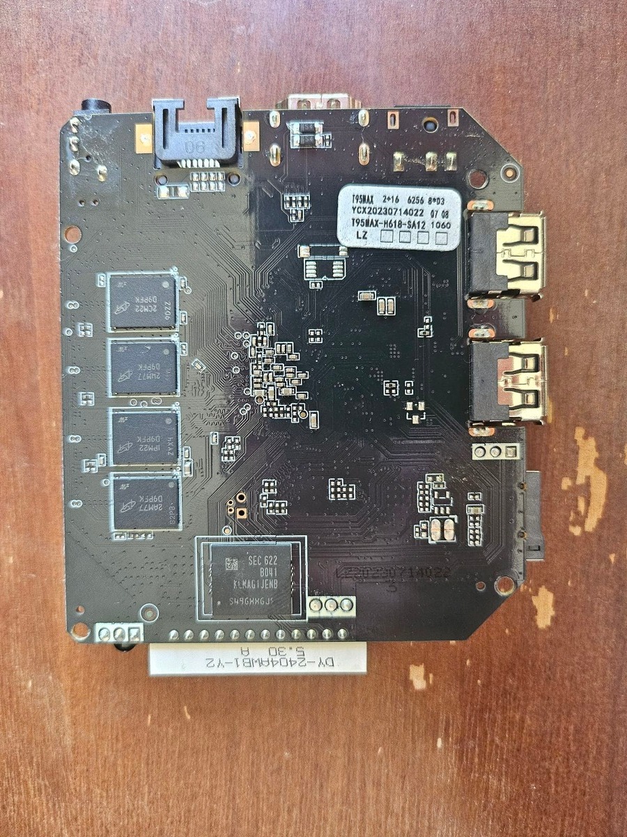

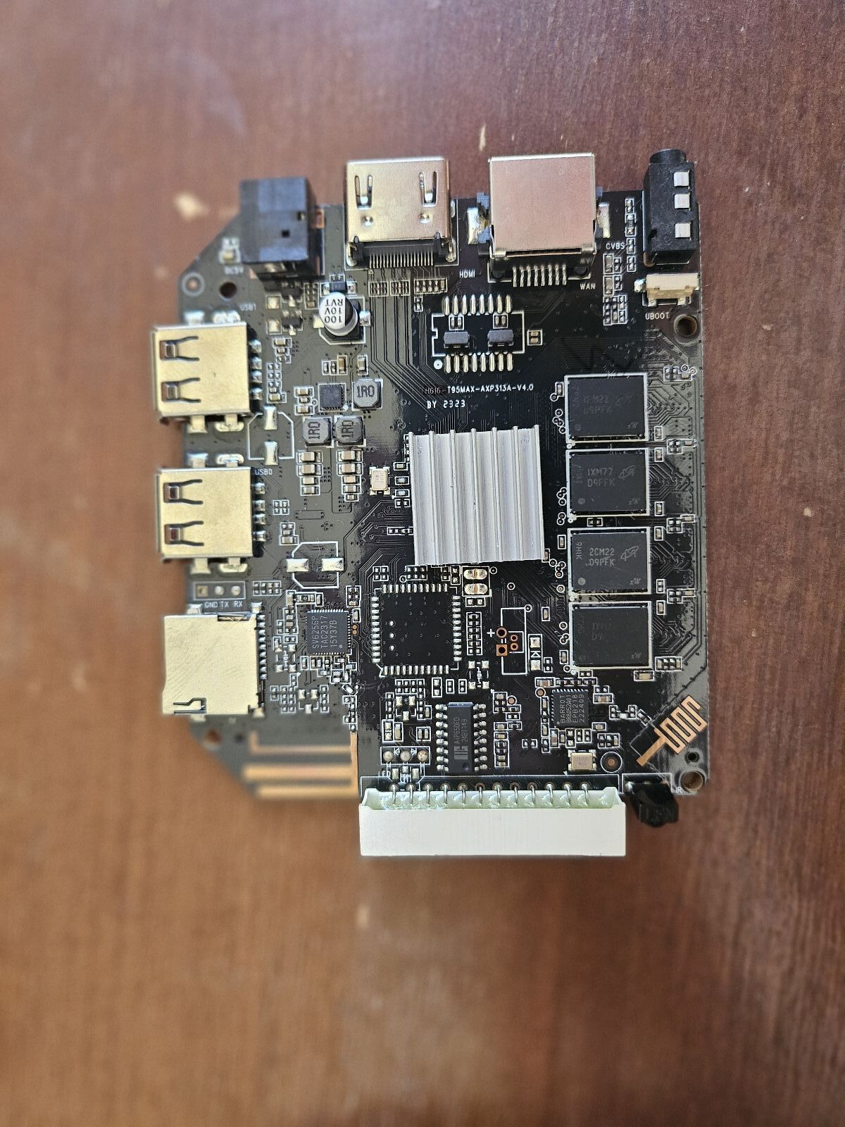

I have this box T95 MAX H618 4/32GB https://www.ottofficial.com/product/android-tv-box-t95-max/
I installed the tanix tx6 image and I get a black screen when trying to boot libreelec from Sdcard
Do I have to do anything after using libreelec usb creator to the sdcard? rename dtb file etc?
Added some pics of the mainboard to help identify.
Thanks
