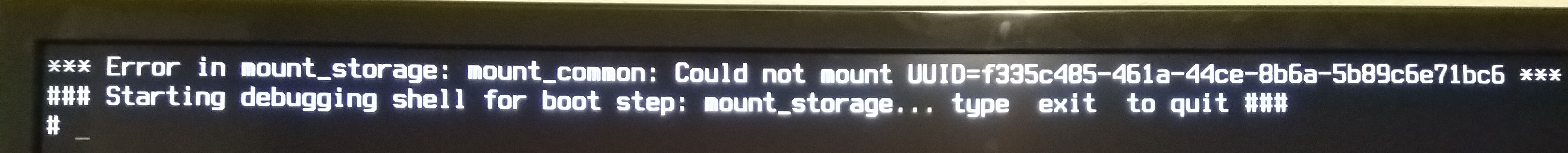

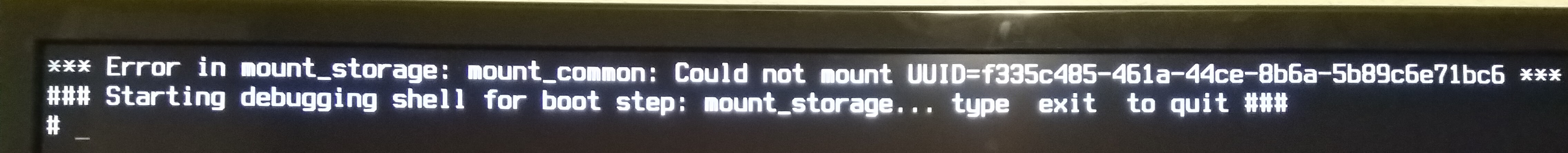

I tried the new RPi2 version but I have the same issue. I see the RetroELEC logo which freezes after 4/5 minutes. When I use the arrow buttons I can see a command line which sais "Starting debugging shell for boot step: mount_storage... type exit to quit"
There seem to be some existing issues with RPi2.
