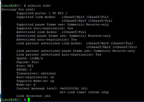

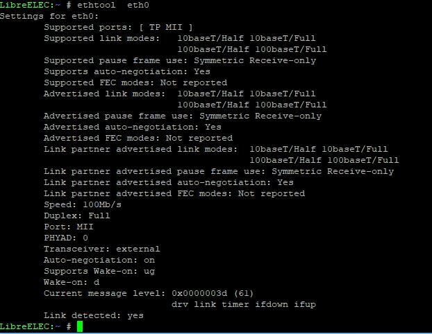

    I reported a similar issue here with my T95Z Plus device. ZRas suggested setting the device to 100M, and it worked for me.
    ethtool -s eth0 speed 100 duplex full

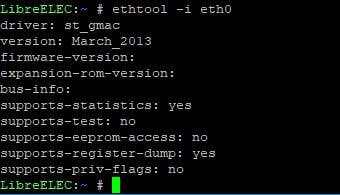

    Thanks a lot, but it didn't work for me :cry: It seems the wrong driver is loaded with wrong advertisement speed (1000 full duplex is missing)

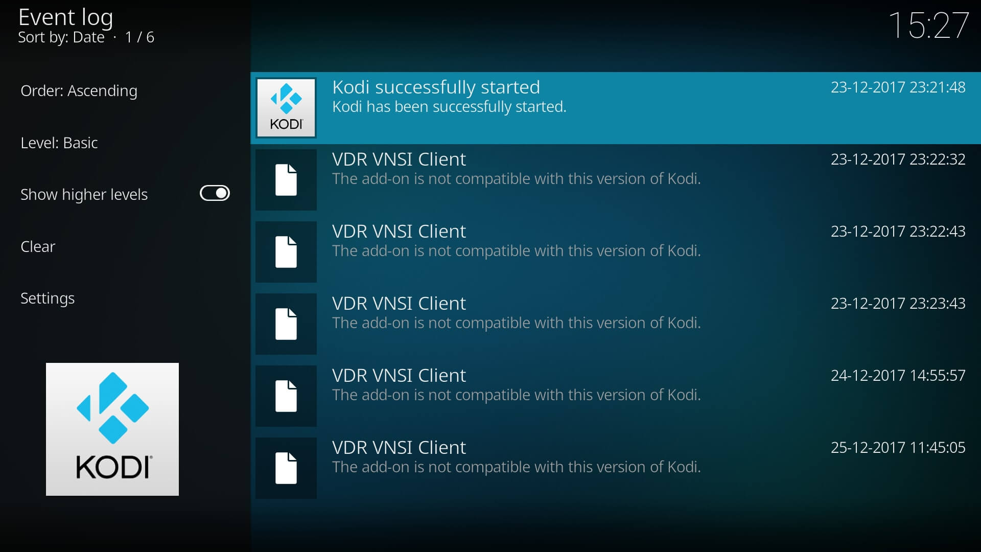

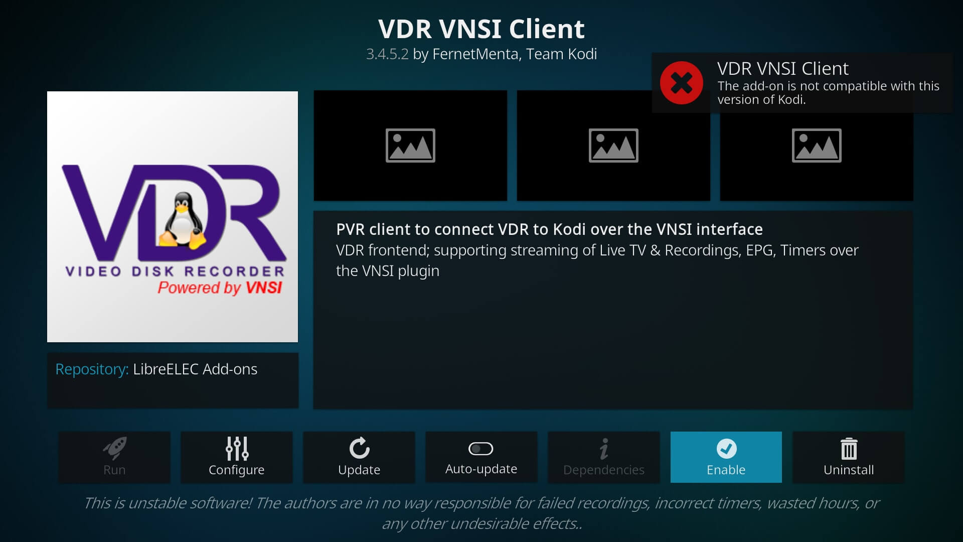

    The error with vnsi client appears when I am trying to update the add-on.
    i have added the screenshots. If needed I can give you also the kodi log.
