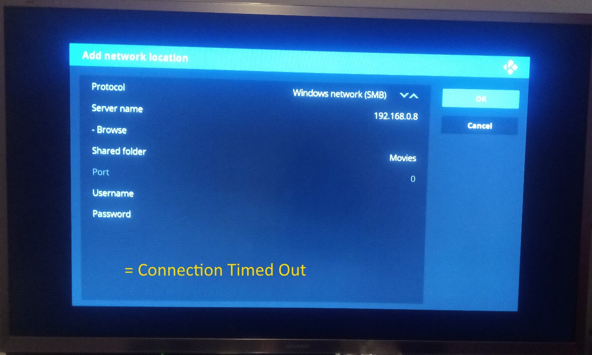

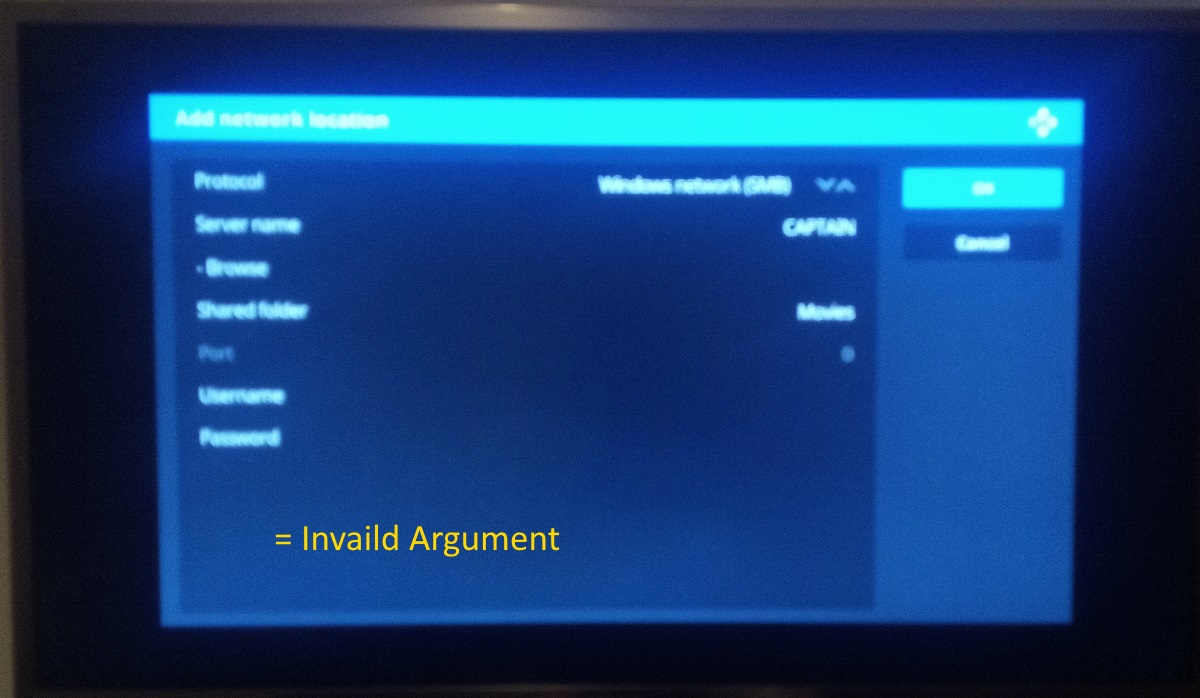

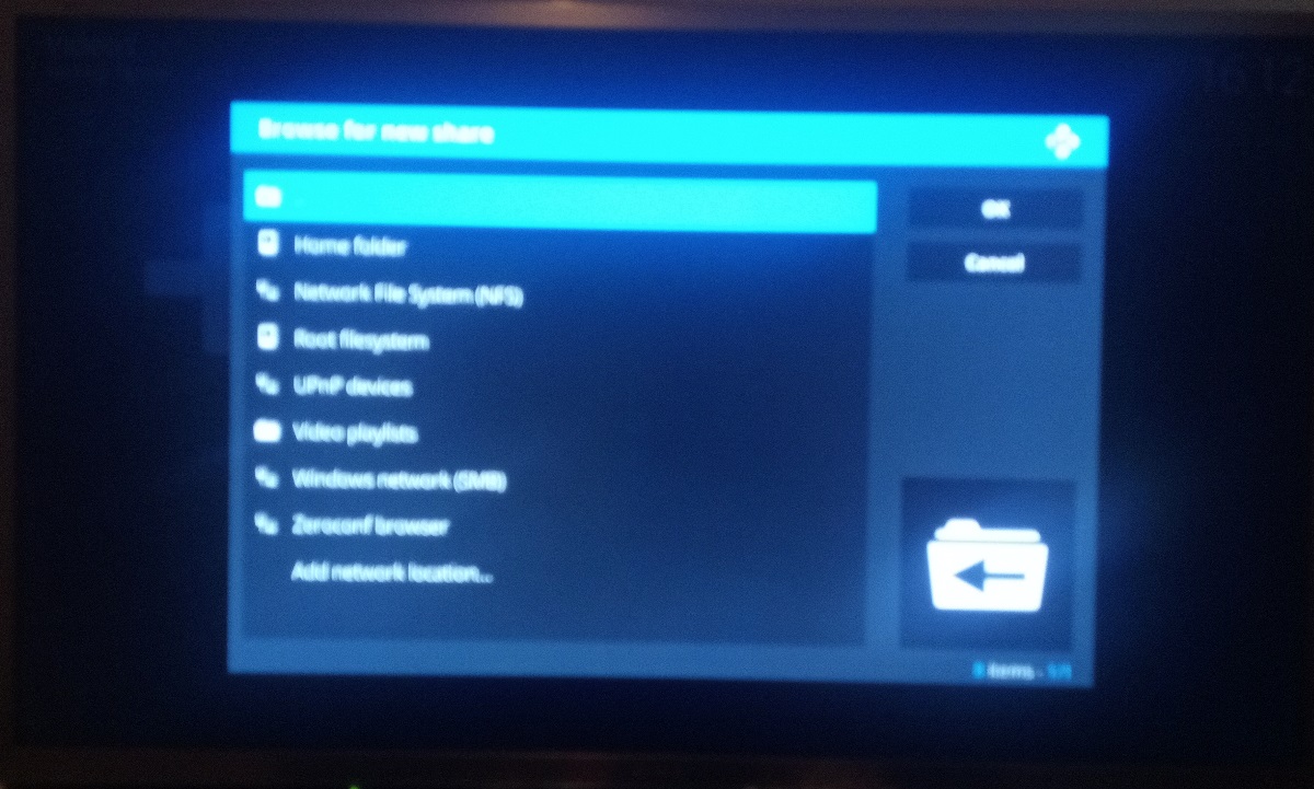

This is what I've been trying on the LE box end.

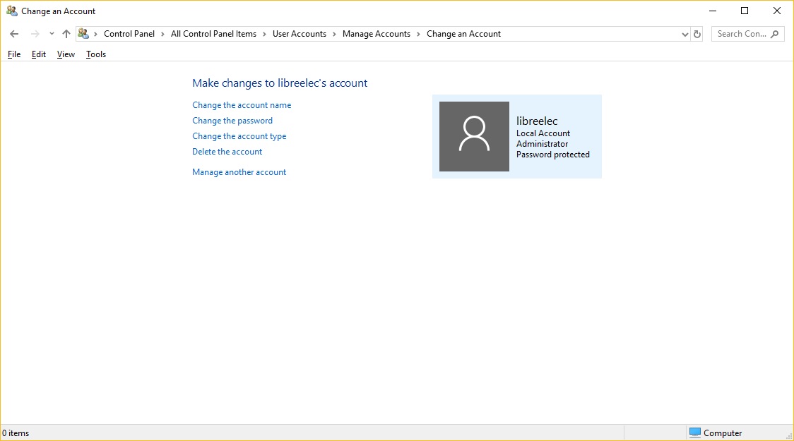

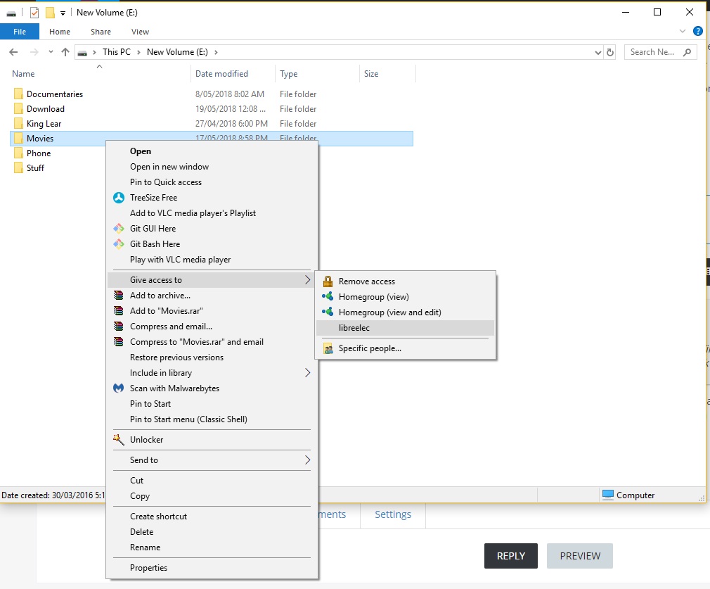

I've done all of that. When I try to connect with the LE box, an 'invalid argument' error window pops up. Maybe I'm not getting the syntax or something not quite correct, I'm not sure. Anyway, some screen-captures from this W10 box, to make sure what I've done so far is correct.
