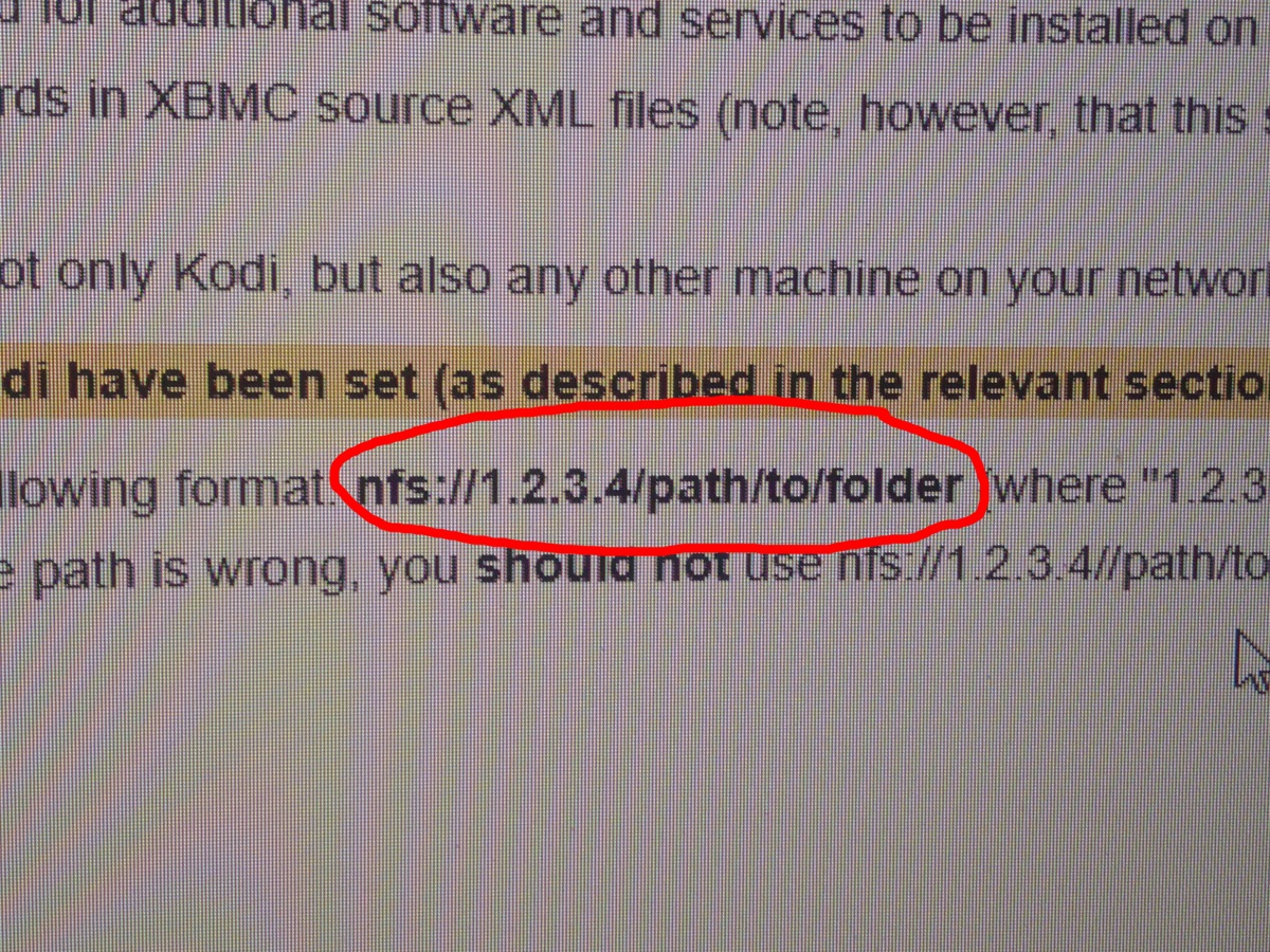

Thanks anyway but I'm done with this a**ehole thing. I've spent nearly three weeks trying to get it to work and nothing has worked. I just spent an hour or so trying NFS (the LE box froze every time I tried it, upnp will not show the shared folders) so that's that.

Thanks for that - I'm going to try to set-up NFS sharing first. If I can't get that working I've had enough of it all and I'll have a break for a while. I can still put files on a USV stick and play them from the LE box.

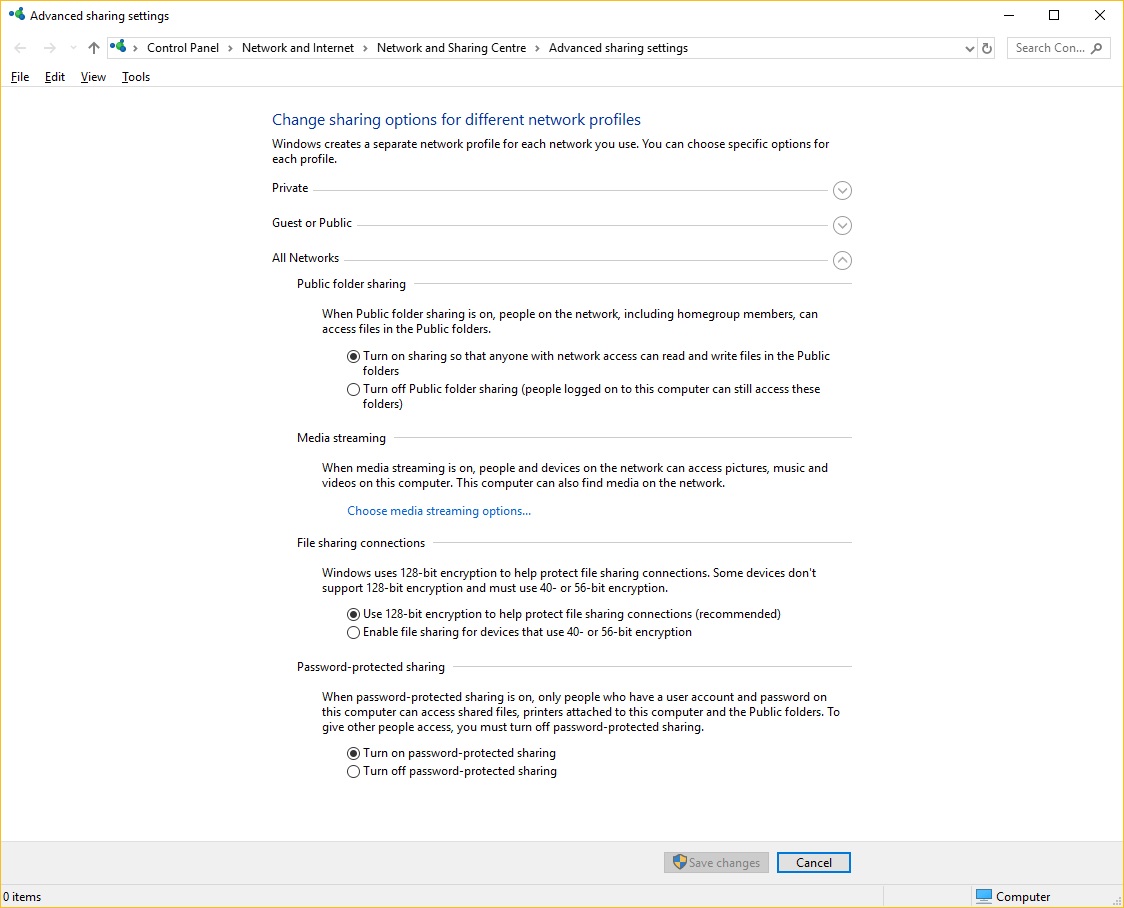

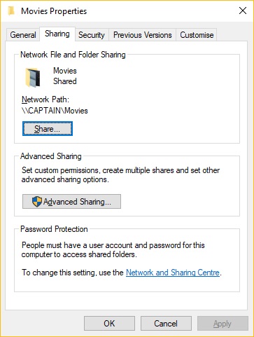

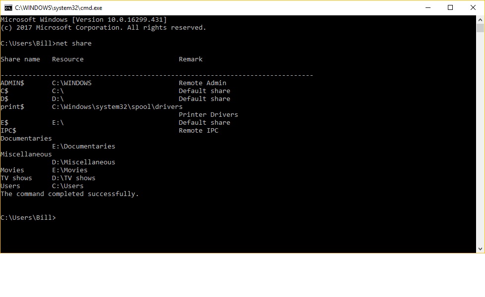

Okay I think I have all the screen captures you wanted.

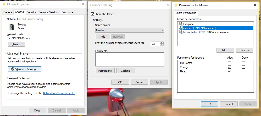

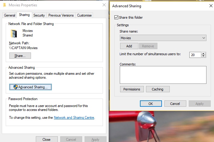

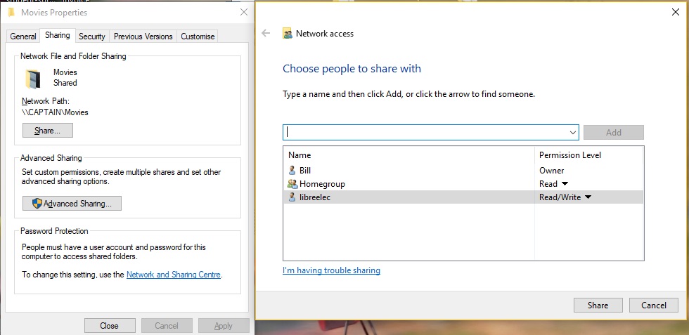

Please show the share settings in windows. If it's your windows user then use this user plus the login password for windows
There's screen captures of those a page or two back I think. And in the last video link I posted.

Again, you should add some media to your Windows 7 computer - set up password protected sharing and try accessing your media. If it works, then your problem is the Windows 10 computer.
Remember, the Windows 7 computer will have a different IP address.
I don't like the idea of editing a password file using SSH. The "add network location" method should work just fine.
I tried on the W7 pc, I turned on sharing needing a password (Change Advanced Sharing Settings) but it never asks for a password in any menu I can find. However, if I go to Add Network Location in the LE box, then use the IP address of the W7 pc along with the shared folder name, it does try to connect. But as you'd expect since the folder doesn't have a password it won't go any further. If I use the name of the W7 pc, it just does the 'Invalid argument' thing again.

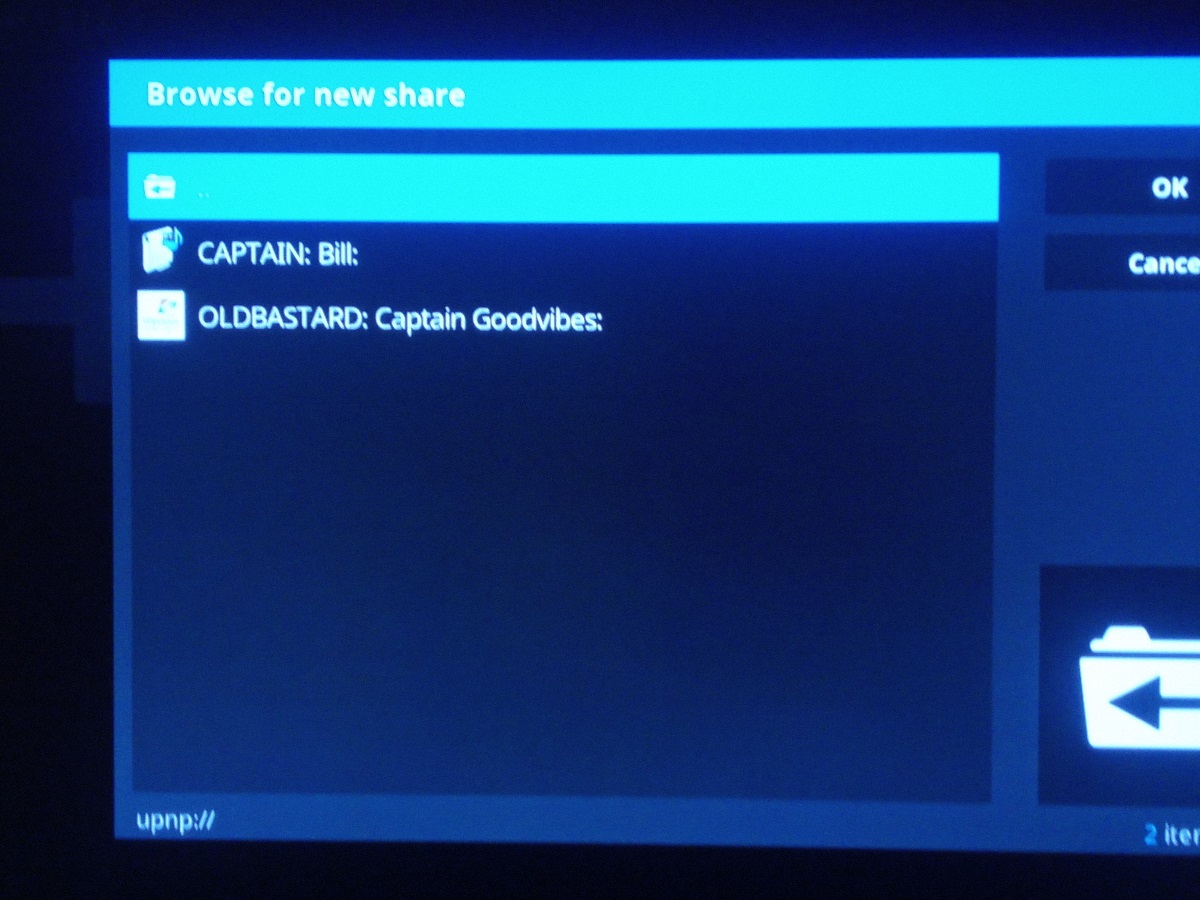

Just going through some of the various network options things, and upnp showed this box. However when I typed in the IP address thing the LE box locked up and I had to re-start it.
I think you have to use username password for a windows 10 share. Use a user with a password for your share
I think I've done that, but if not can you please explain where I need to add/use that?
