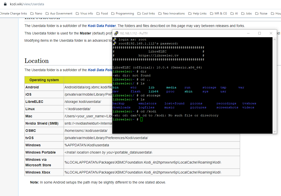

I tried doing what is written at - https://wiki.libreelec.tv/support/log-files
But there is simply no 'paste system logs' to be seen anywhere.
So the attached photo is as much information as I can get sorry.I rebooted it, got this updated log page.
Again, nothing on the Wiki page works. I used to be able to SSH into the box, now that doesn't work either. -
