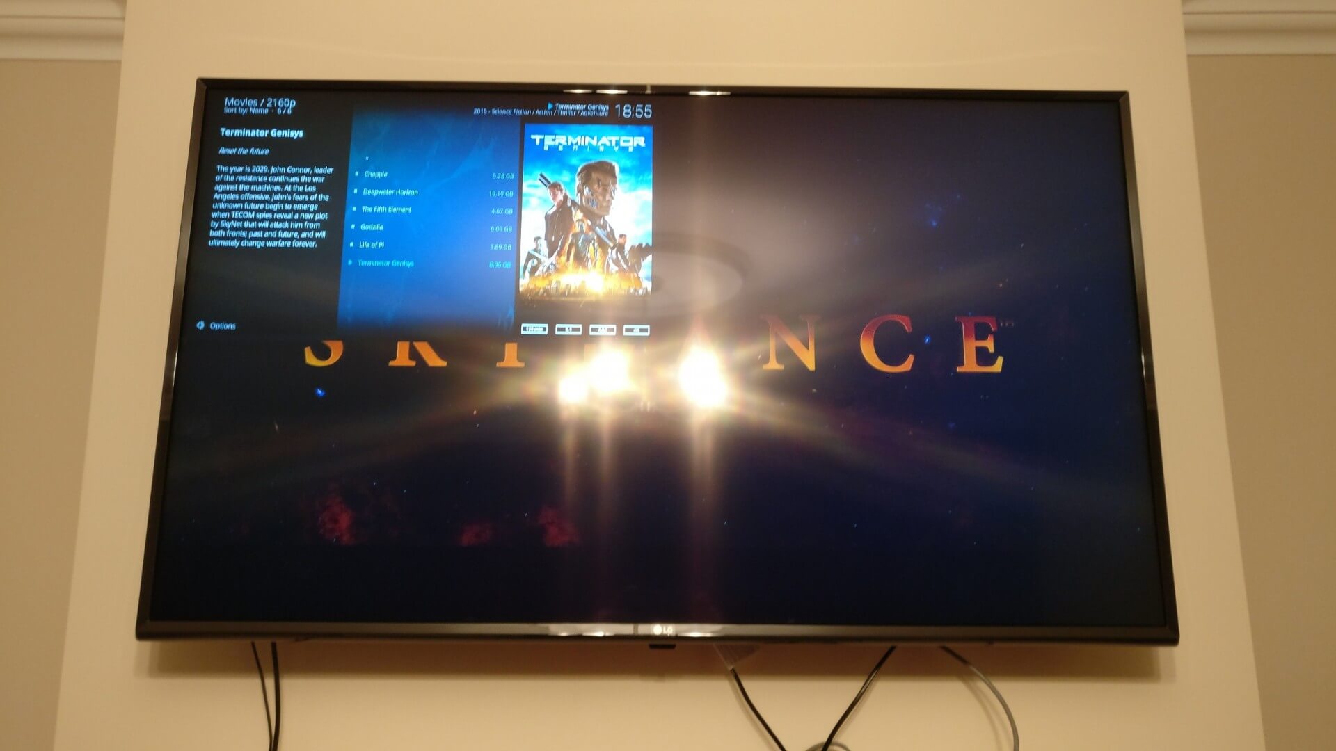

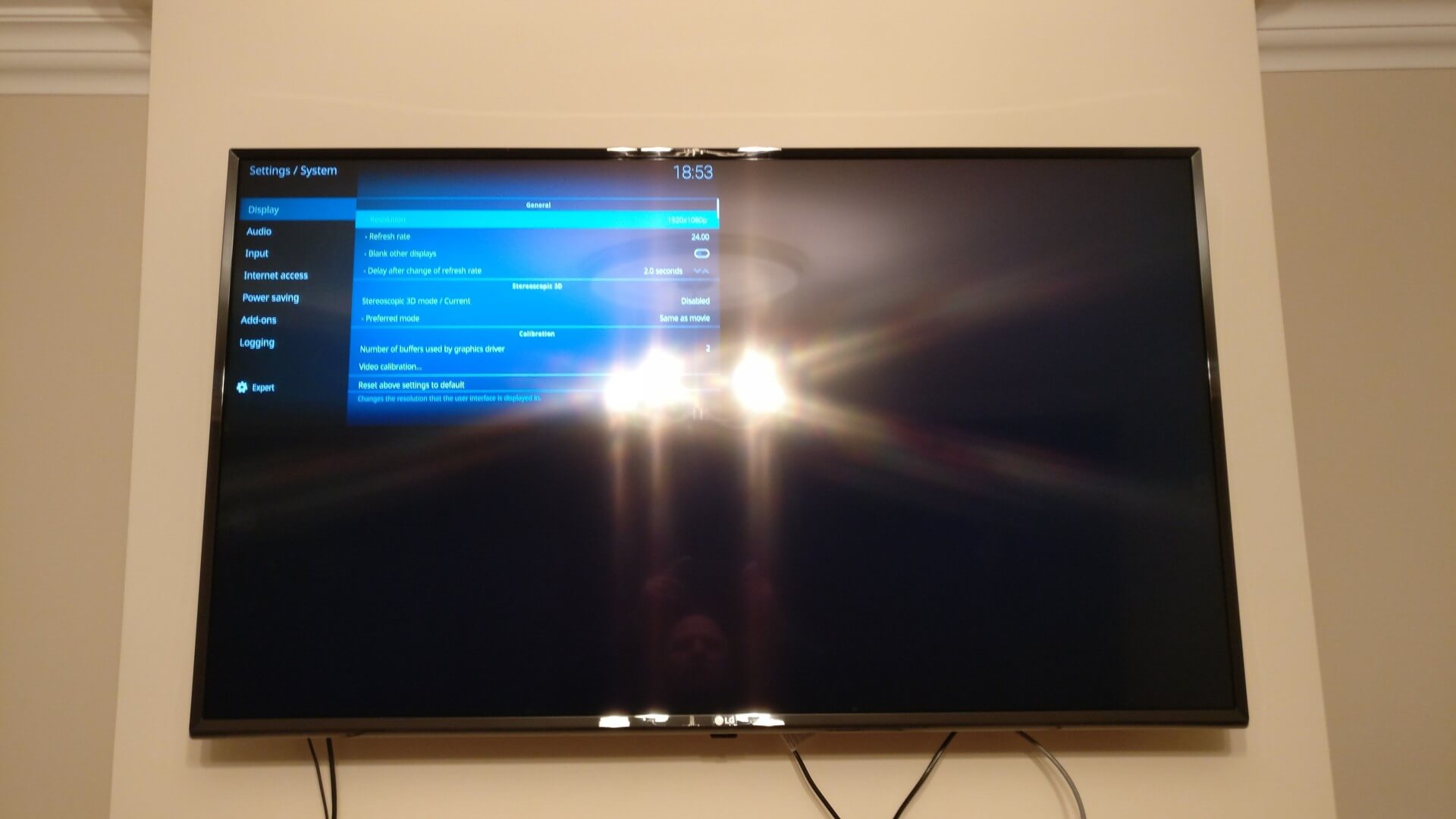

Photos attached.

Would a screenshot of the problem help?
I've got a strange problem with 4K on my Neo X8H Plus running 8.2.2.
If I change the resolution of the Kodi interface to 4K the TV just displays a static 1080p image in the top left quarter of the screen. The image appears to be what was on screen immediately before the Confirm/Revert resolution change message.

If I leave the Kodi interface at 1080p and then play a 4K video, the TV switches to 4K @ 24Hz and plays the video. However, a static image of the Kodi interface is overlayed in the top left corner as above.
