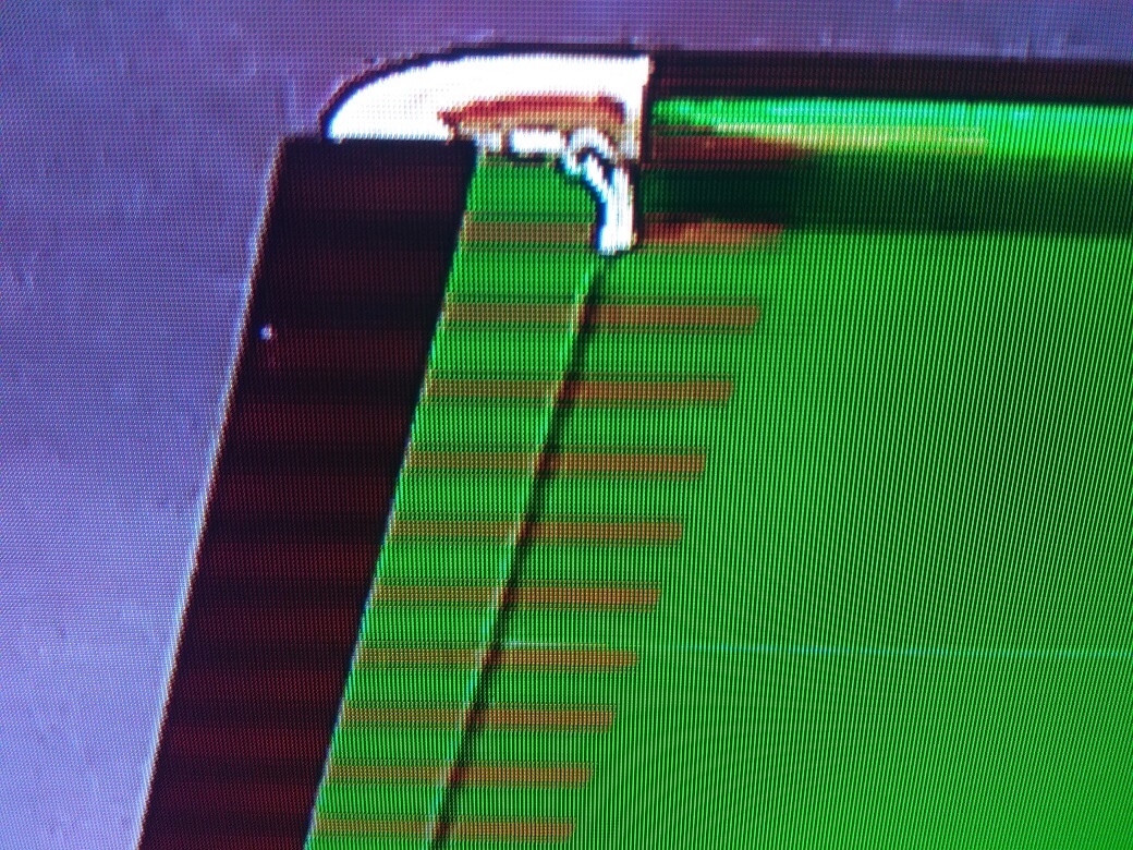

There are no artifact, you probably mean red color flaring. This is common know issue for K3 Pro (S912). It was reported also for Android DTV apk.
My box also has this illness. I found it also in T95X (S905x) box. It have to be hw construction flaw. I was thinking about overheating, but keeping CPU temp < 50°C didn't remedy picture. I've never got this issue on S905/S905D. My recommendation is to replace K3 Pro with K1 Pro, the best box with sat tuner. Or buy cheap S905 for frontend and use K3 Pro as a backend server.

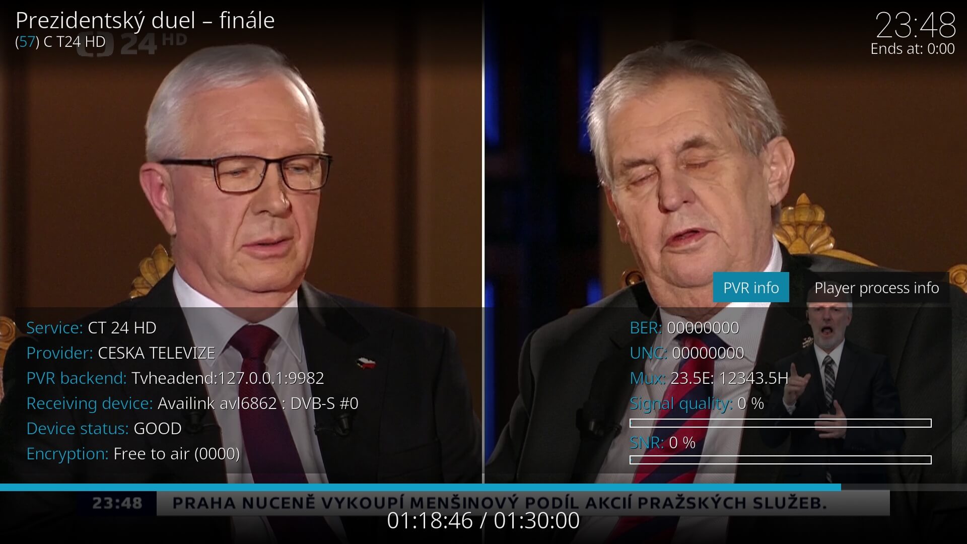

Hello, as I wrote some pages before I have problem with picture on LiveTV with my KIII Pro (S912) on some channels. Now I get Tanix TX3 mini (S905W) box and I checked if problems are on S912 only (libhybris problem). But I found that if on S912 are problems after some time on S905 I have problems always when I start playing. Can anybody check this channel (its free) if picture is OK?
Channel CT 24 HD:
Astra 3A - 23,5 E
12344 / H / 29900 / 2/3 / DVB-S2 / 8PSK / HD
Thanks for your help.
Marduk

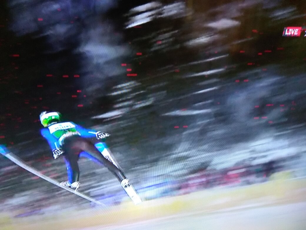

Hello, I have the same troubles as here described (KIII Pro - some LiveTV channels) - its S912:
[8.90.3] LibreELEC 9.0 Alpha for S905/S912 devices
I found the same problem on S905:
Tanix TX3 MINI - Amlogic S905W (New SoC) - Android 7.1.1 - FreakTab.com
- Appears during video playback in some players
And here is temporary solution on Android on S905:
- Yes I've noticed the same problem. I solved it by turning off "resolution deep color" in settings but every time you reboot box it's activated again so you need to turn it off again. Also "color space and deep color settings" best works with 444, 8bit
Is it hellpfull for fix in LE with S912?
Thanks. Marduk
