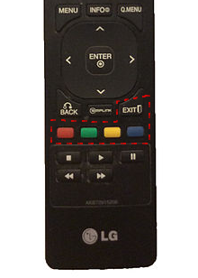

    This is my LGTV remotesecond.conf file:
    This is used as CEC enabled. It only remapped few buttons since most of them already works through CEC.
    - Exit now is mapped as 'Home', it was acting the same as 'Return'
    - Red is assigned as 'ContextMenu'
    - Green is 'o' to bring up codec when play videos
    - Yellow now can take screenshot which is saved in /storage/screenshots
    - Blue is 'L' to switch 'Subtitles'
