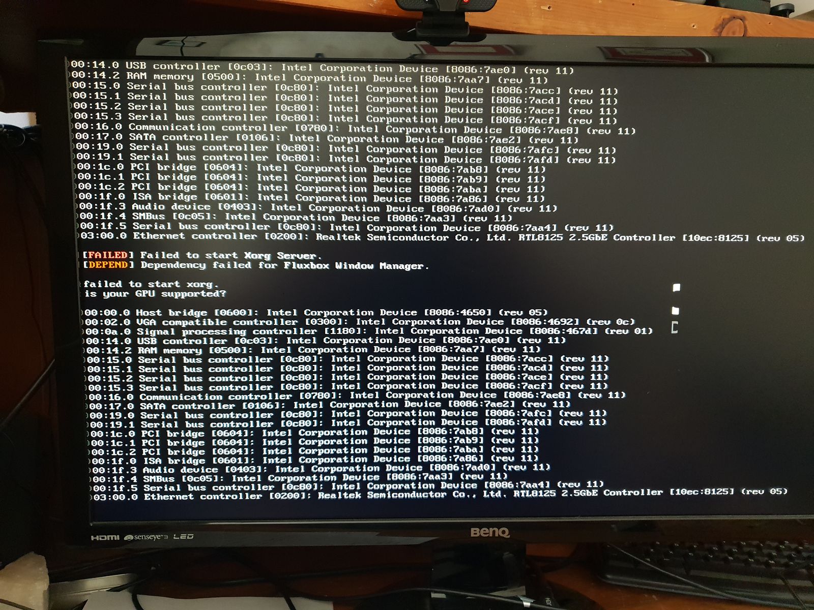

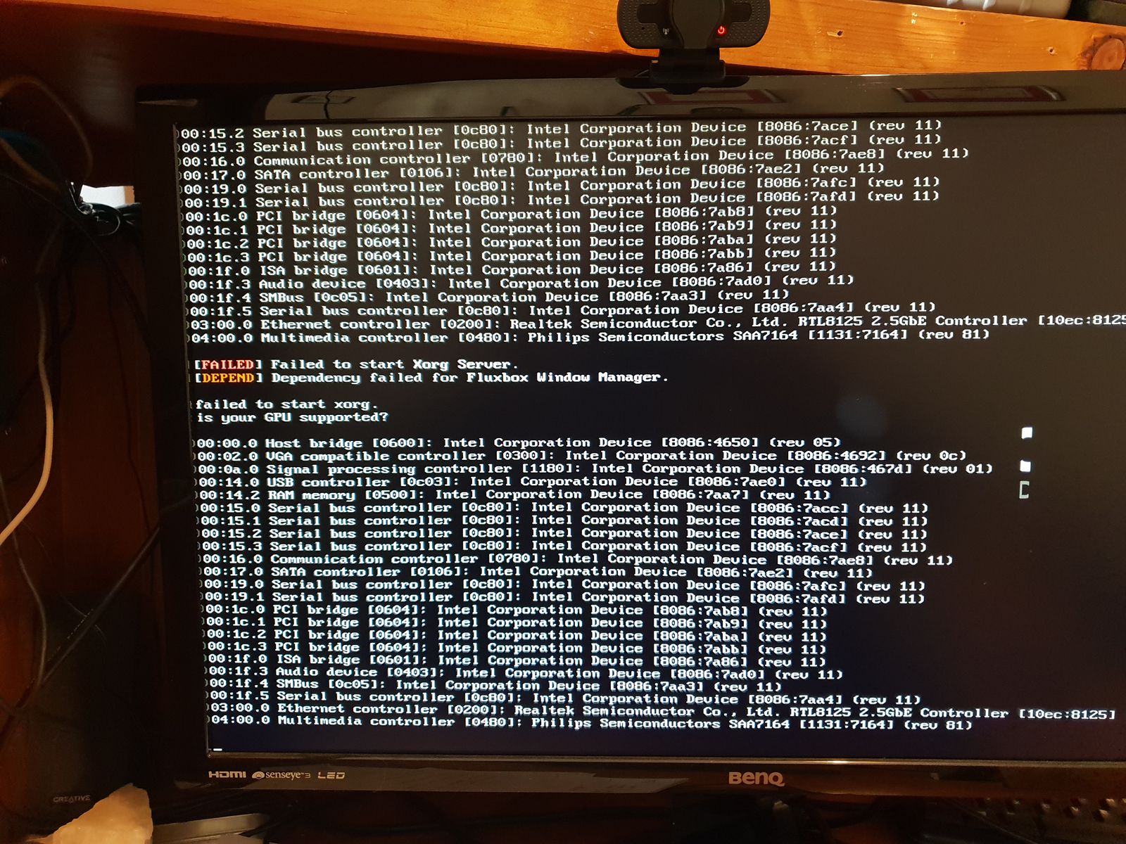

just tried the latest Generic build however still have the same problem, again I have attached the screen shot
ps. I have attached a screen shot of the error message:
The Build I tried was: orangepi-win and roc-pc-plus, the message was as above, ie.
failed to start xorg/is your GPU Supported? I an about to try pine-64
I have tried without success, there are a number can you suggest a particular build?
Hi, I am a long time user of libreelec and have decided to upgrade my hardware however get the following error message:
"failed to start xorg/is your GPU Supported.
My new hardware is as follows:
CPU - Intel 12th gen Core i5 -12400 which has "Intel UHD Graphics 730"
Motherboard - Gigabyte B660 LGA 1700 and states it has Onboard Graphics Processor - Intel HD Graphics Support
Any help would be appreciated as I have just spent a lot of money on the upgrade.
