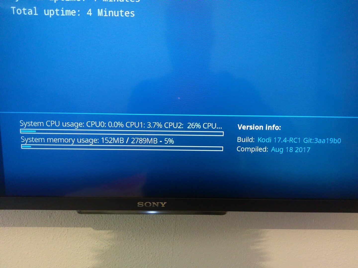

    Thank you for your efforts to Fietspomp your instructions made setting up my Z69 so much easier!
    Out of interest how warm does your Z69 run?
    I'm tempted to dissemble mine to re-thermal paste and drill some air holes... 50oC + seems high for a S905.
