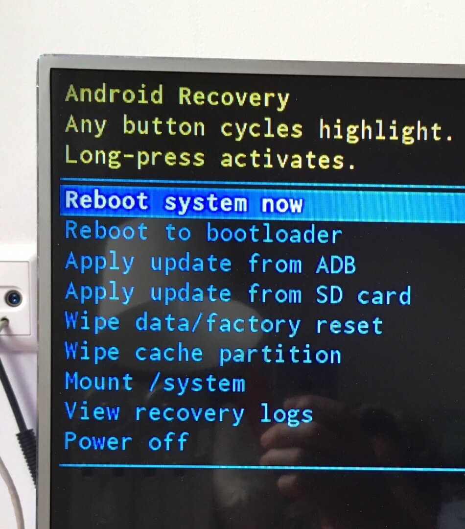

    Hi,
    I tried to install 8.0.2e on my new MXQ pro 4K with a S905x. I followed above procedure and used this device tree: gxl_p212_1g_nand.dtb
    When use the toothpick method to get into recovery mode it does not start libreelec but shows the screen as attached. I tried all functies in the menu but non did something useful. I tried different device trees, but all with the same result. I also tried to reinstall the usb card. Nothing works.
    Any ideas?
    many thanks,
    wessel
