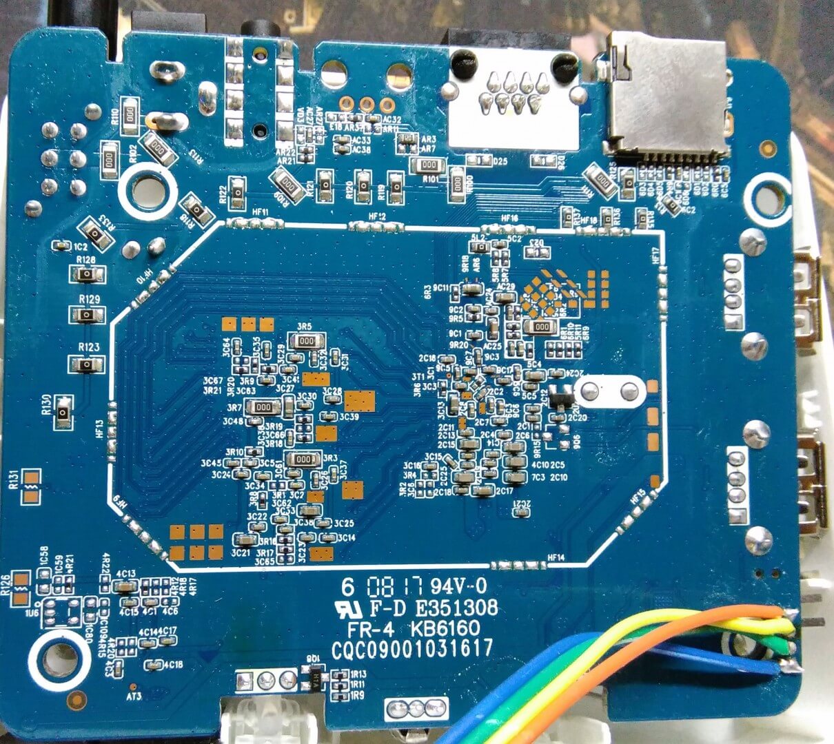

I've got an S905L-B box a few days ago, and I tried to intall kszaq's S905 LibreELEC build on it. But I found that all existing dtb.img are not working properly. None of dtb files for S905L and S905D would boot properly, and all dtb files for S905 have no USB device accessable. When I use dtb file for S905, the box would boot properly, but no USB port would work.
So how could I get a working dtb.img? What can I do to help the devs figure it out?
Here are the pictures of board of box.
