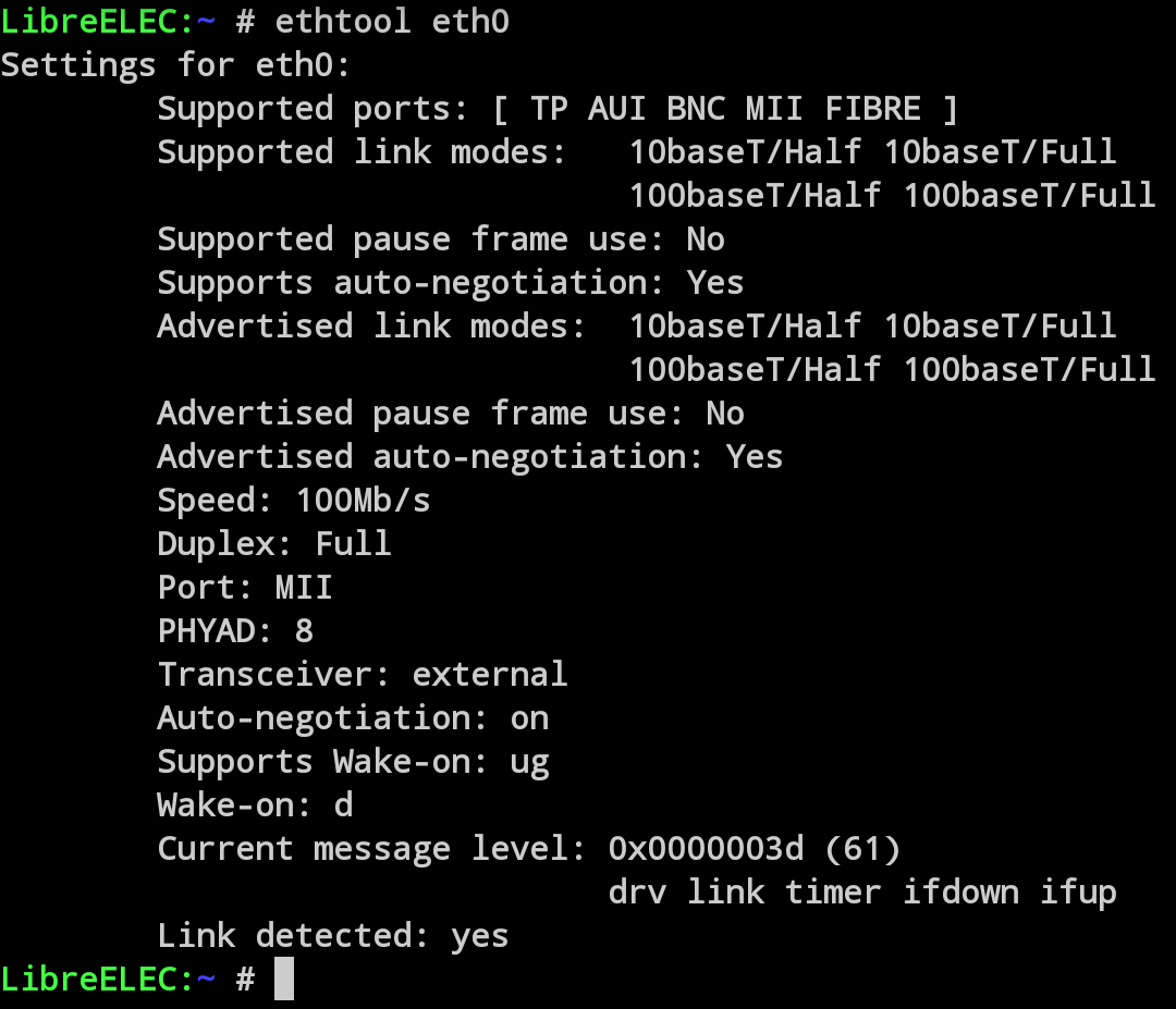

Hey,
I habe a question. I bought this OTT TV Box M9S Z8 S905x
The description says this box has Gigabit Ethernet Port. Ist this right?
Because "ethtool eth0" say 100mbit!
I used gxl_p212_2g.dtb, was it wrong? -
