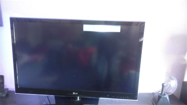

    Et voilà :
    After starting an Xvid file, my problem appear
    I can see that framerate is adjusted 10 seconds after lauching the avi file and then screen appear like the photo I've provided
    Hello,
    I've got a problem since I 've moved from Openelec 6.0.3 to Librelec 7.0.1 (updated version) on my rpi2.
    On some xvid media (not all),the framerate is not set at the beginning but 5 or 10 second later...
    Stream starts, plays for a couple of seconds and then switches the TV to the target refresh rate.
    When Kodi doing this, I got a little rectangular screen with a part of the movie and the rest is black...
    I have to display the play menu and then everything is ok.
    This problem not appear when "Switch framerate" is OFF.
    If anyone got idea ?
    Thanks
