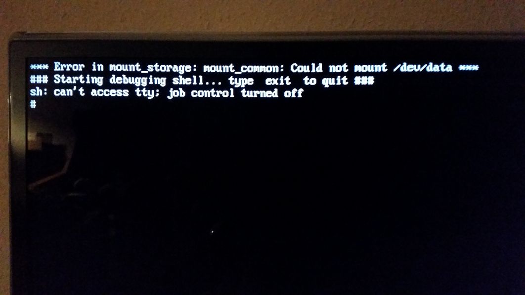

    I let the box alone for a while (about 15 or 20 minutes). As i returned I got a message on the screen stating "unable to mount /dev/data"
    And giving me a debug shell.

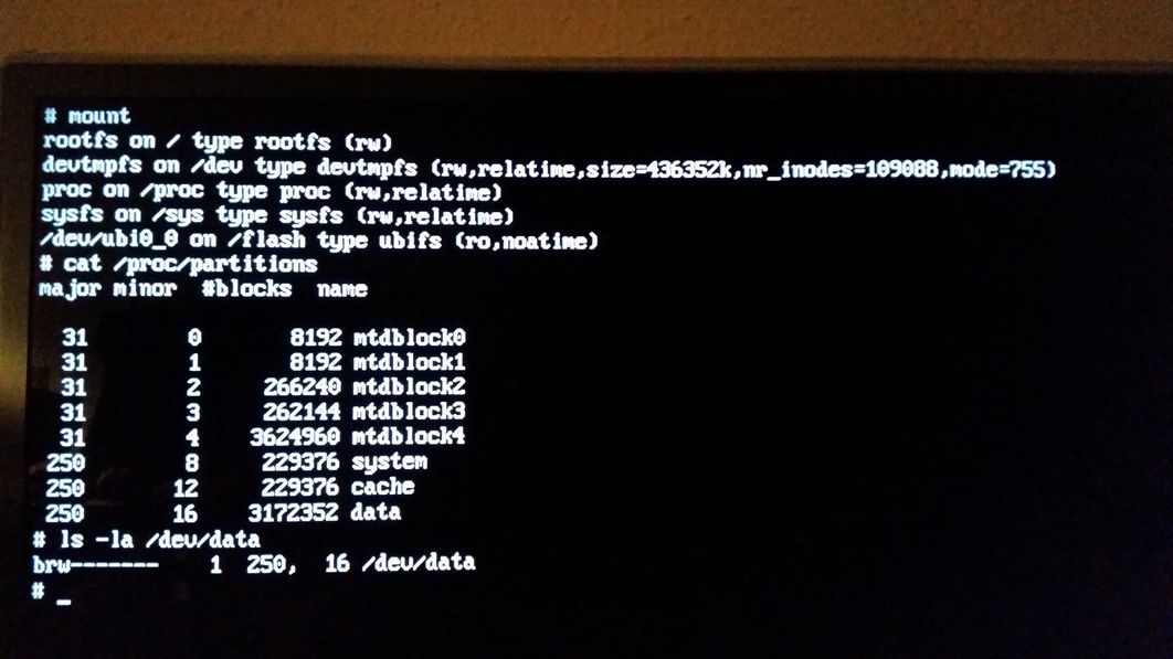

    Manually mounting /dev/data to /storage fails with "invalid argument"
    I gathered some hopefully usefull output.

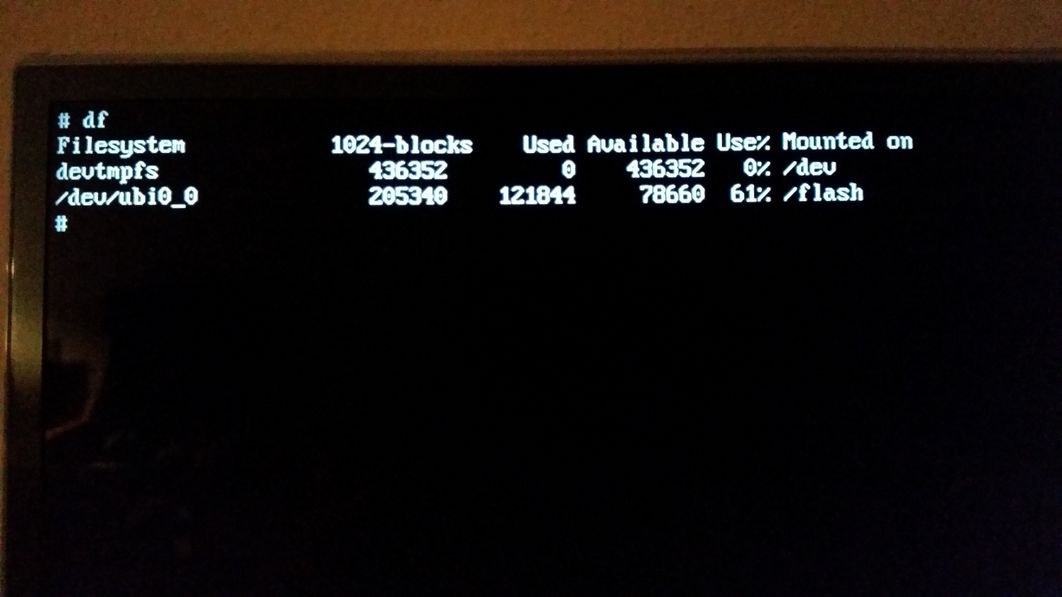

    Update:
    I made another clean install of 7.0.2 to gather "df -h" output, busybox does not support "-h".
