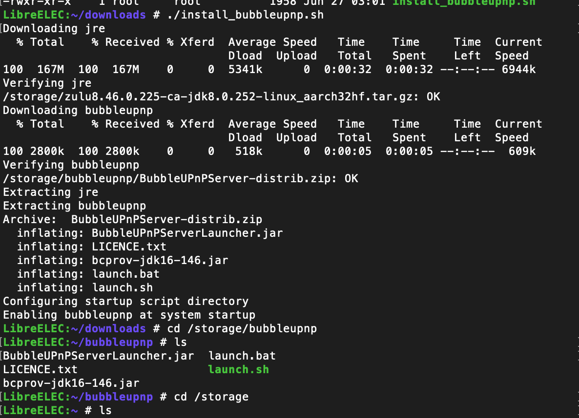

    Is anyone able to take a look at the installation for me? (photo in last post).
    Also being new to command line: do I need to run/install this script in a specific location in LE, rather than from the downloads folder as I have?
    Thank you and sorry for the severe lack of knowledge...
    I have not had any success contacting the author of the script.
    Try upload bubbleupnp install script to your LE and run it via ssh
    OK so I have bumbled through and learned how to run a script via ssh. Turns out it's very basic linux knowledge indeed (for anyone that is intimidated, as I was!).
    I ran the script I linked in the first post and it "appears" to be working (in that I can send a local AVI movie to chromecast that would only play the audio before- this is with my NAS disconnected so I know it's not the NAS installation doing the transcoding) . The output is attached after installing.
    Yatse reports "unknown BubbleUPnP error" when checking the connection, but it still appears to be working and plays the file. I do not know how to test/confirm.
    Am I mistaken or correct in my assessment do you think??
    edit: further tests suggest that maybe the hardware is not being used to transcode? I have 2 h.265 test files (from Sample HEVC Video Files) which will play, but with stop/start jittery playback.
    I also cannot access the server at [LEipaddress]:58050
