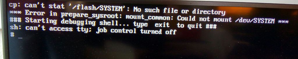

    Error:
    Error in prepare_sysroot. mount_common. Could not mount /dev/SYSTEM
    Starting debugging shell... type exit to quit
    Cant access tty; job control turned off
    I tried Drieschels image, too:
    LibreELEC-S802.S82.arm-8.0.0-2-alpha-devel.img.gz
    SD Card:
    kernel
    kernel.img.md5
    system
    system.md5
    cp: can´t stat ´/flash/system´: No such file or directory
    ***Error in prepare_sysroot: mount_common: Could not mount /dev/System ***
    ### Starting debugging shell... type exit to quit ###
    sh: can´t access tty: job control turned off
    #_

    Error:
    cp: cant stat ´/flash/SYSTEM´: No such file or directory
    Error in prepare_sysroot: mount_dommon: Could not mount /dev/SYSTEM
    #_

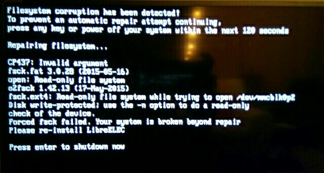

    Can´t find a working image or files are missing. Tried all of Drieschel and Demetris. All showing "Filesystem corruption detected" or "Read-only filesystem".
    I never used a device tree file or remote conf file.
    Tried 4 SD cards and a SD card reader on both USB. Without success.
    Should i or is my box exotic cause of the S83B?
    Thank you.

    Save release SD Card from PC
    Insert to box
    Get error message :( See attached file.

    122.2MB Mar 12, 2017 | 09:00PMGot an error while booting from SD. Something like "filesystem corrupted".
    I tried a 2 GB Kiingston micro SD and a 32 GB Sandisc micro SD.
    Used Rufus 2.12 and Libreelec USB-SD Creator with same result.
    Did i take the wrong image? Do i have to use LibreELEC-S802.arm-8.0.1a-S82.tar and LibreELEC-S802.arm-8.0.1a-S82.img.gz?Thanks a lot.
    Edit: Tried all of these images: "Filesystem corruption detected" and "Read-only filesystem".

    Boot from SD is working but it stucks and shows:
    #_
    Wheres the mistake?
