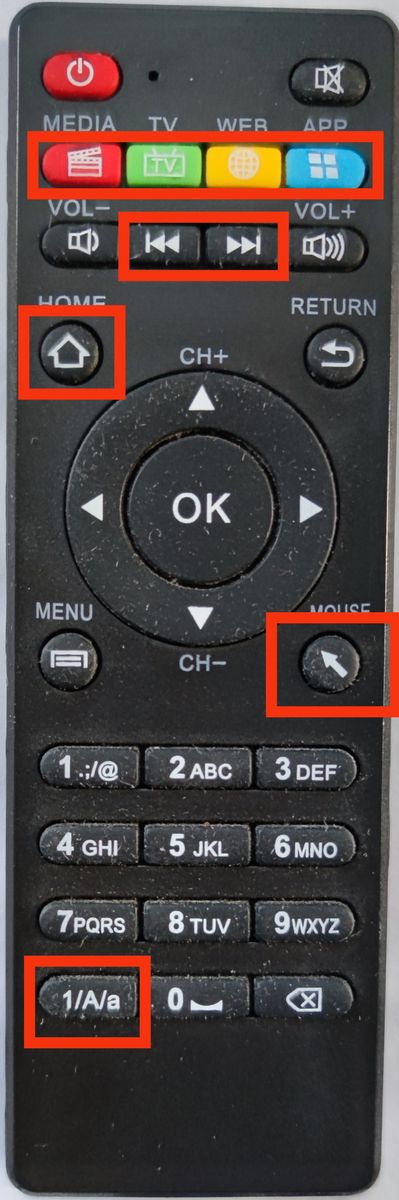

ilmich thanks for the detailed explanations.
Тhis is the result of the buttons not working before:
button HOME = KEY_HOME
button MOUSE = KEY_O
buttons PREVIOUS, NEXT, 1/A/a - they are not touched as you said
buttons RED, GREEN, YELLOW, BLUE - something is wrong here. LED flashes but no reactions in Kodi. I installed an Add-on Keymap Editor and it shows the same longer code 16839168 for all four buttons. For comparison, the HOME button is 61622 - only five digits like all other buttons.

Display MorePlease explain what happens specifically (which keys don't work or just if you want to remap them).
Compiling a dtb is easy (you can find guides on google). But I can also compile it for you.
I only have 2 or 3 remotes, so if something new comes up that I can include in the build it would help others too.

I am attaching a picture of my remote.
The buttons outlined in red don't work for me and when I pressed them even the LED does not blink.
I just want to be able to use them too.
