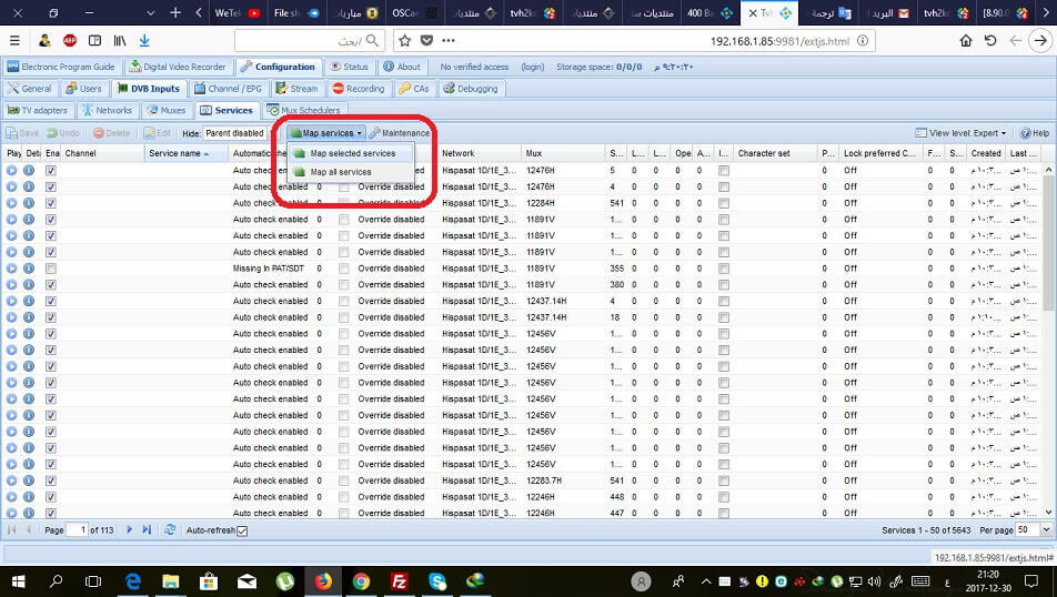

I mean the order of channels A -Z
In which menu?

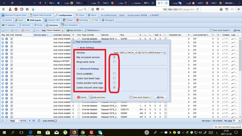

ET ADD map sattelite one only et map selected channel
Is it possible for you to post a screenshot of what it currently looks like?
belaid38 can you show me on my addon which area - kodi screengrab? I'm not clear on where you want to sort channels by alpha.
Currently, I have map channels set for all available services.
Are you looking to add a map selected channels function to my addon?
