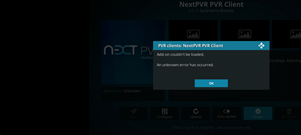

    The kodi client addon for NextPVR does not load though.

    The NextPVR addon, message.

    If the add-on is not working on multiple platforms it should be reported to the developer via the add-on support thread in Kodi forums. We take a major interest in things like TVHeadend as it's so widely used, but for clients like NextPVR we just build whatever Kodi provide. If what they provide doesn't work it needs upstream attention.
