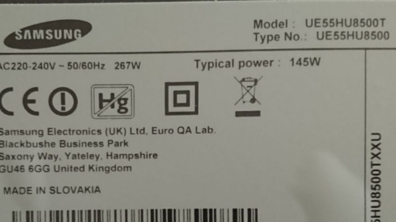

* s905x
* 7.0.3.012k
* T95N
* TV no support 4K -
The topic title suggest it is an UHD tv and the label says 55HU8500 so why do you think "tv no support 4k"?
Anyway, 012k version produces same strange screens on different devices so try 012j instead.
